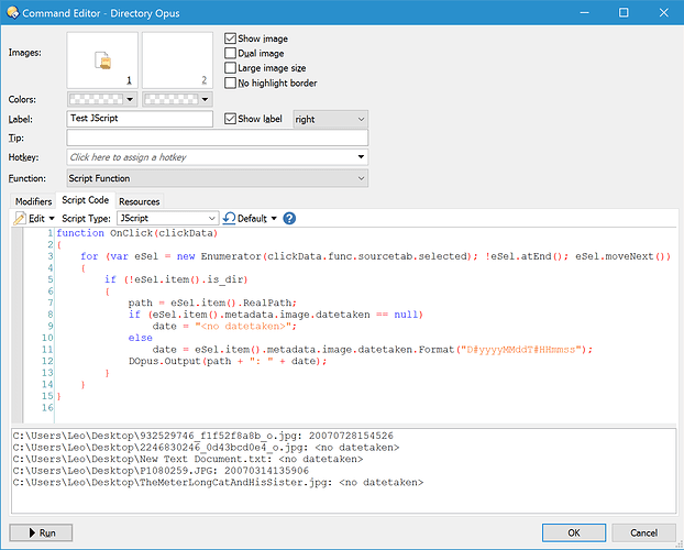

Seems to work here (at least in my development build; I haven't double-checked with the beta installer):
function OnClick(clickData) { for (var eSel = new Enumerator(clickData.func.sourcetab.selected); !eSel.atEnd(); eSel.moveNext()) { if (!eSel.item().is_dir) { path = eSel.item().RealPath; if (eSel.item().metadata.image.datetaken == null) date = "<no datetaken>"; else date = eSel.item().metadata.image.datetaken.Format("D#yyyyMMddT#HHmmss"); DOpus.Output(path + ": " + date); } } }
Your Jscript worked fine for me too, so not sure if its just the VBscript issue or something else, but here are my results:
