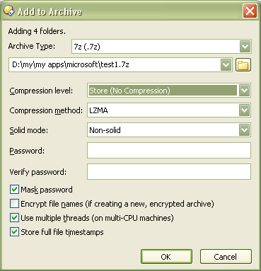

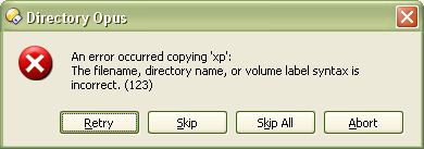

@teefan: I'm curious what all your other options are set to (screenshot of the dialog?) when you create the initial non-SFX archive...? Also, what command or menu item were you using to create the SFX archive all in one go? I'm trying to reproduce your issue - and actually... I can't even get past the "second" issue you're having:
@Leo: in an attempt to try and create a similarly sized archive as teefan... I've selected 1.89 GB of files in the following folder having been selected:
.net media utils xp
When I do this with the following options:
I get the same sort of error as teefan second "issue":
...and the resulting 7z file is just 32 bytes.
Digging more - I'm seeing this issue happen anytime multiple items are selected - not just folders... the name of the file(s)/folder(s) seem to have no impact (unlike teefans observation about upper case and spaces, etc), and flipping various options around in the archive options dialog seems to have no effect on this particular error. The error message always mentions the last item selected.
Note sure when this started - as I don't use the plugin to create 7z archives... but I'm CERTAIN I tested this during the beta and it worked fine. Regular zip compression still seems ok, just 7z compressing of multiple items so far.

I've reproduced both issues and submitted bug reports - though Leo is already participating in this thread :wink:.
  1. I think we have identified where the problem is, though the issue isn't quite closed yet (need to confirm something).
  2. I've found & fixed the problem. The issue was introduced by a change I made in 10.0.0.5, and will be fixed in 10.0.0.6 (or whatever version is next).
