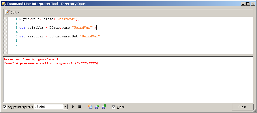

If you access a variable by index which does not exist, DO will not throw an error, additionally if you read the .persist property afterwards, it seems to create the variable. The Exists() method suddenly returns true even though the variable has not been set explicitly. Is this the way it should work?
Watch screenshot and maybe test for yourself:

I don't see any problems here.
Ok, so you do not expect this code to "blow" at line #3 already. You hopefully don't mind if I ask why not? o)
Notice: The error below is for line #5. Thank you! o)
Line 3 of those returns a Var object. (It may not contain a value yet, and may have just been automatically created by using a variable name that did not exist yet.)
Line 5 returns the value inside a Var object.
They do different things, and until the Var has a value, the explicit Get call will fail.
If line 3 triggered an error, you would not be able to do this:
DOpus.vars("WeirdVar") = 1;
as an alternative to this:
DOpus.vars.Set("WeirdVar", 1);
Ah ok, now I get what's behind these two. The documentation btw. says: "Get()" is an alternative to indexing the collection, which then is not entirely true if "Get()" only returns the value, not the object. At least this all explains why I get different behaviour when using "Get()" or the collection directly, thanks! o)
