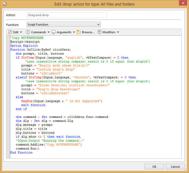

Apart from that, I also found a way of how to fix the issue with the tool tip.
Here is the new code (1st and 2nd line added) which I am 100% happy at the moment:
[code]'Copy MOVEWHENSAME
@script:vbscript

Function OnClick(ByRef clickData)
dim prompt, title, buttons
if StrComp(Dopus.language, "english", vbTextCompare) = 0 then
'case insensitive string compare; result is 0 if equal (how stupid!)
prompt = "Really move these file(s)?"
title = "Confirm drag'n drop"
buttons = "&Ok|&Abort"
elseif StrComp(Dopus.language, "deutsch", vbTextCompare) = 0 then
prompt = "Diese Datei(en) wirklich verschieben?"
title = "Drag'n drop bestätigen"
buttons = "&Ok|&Abbrechen"
else
MsgBox(Dopus.language & " is not supported")
exit function
end if
dim command : Set command = clickdata.func.command
dim dlg : Set dlg = command.Dlg
dlg.message = prompt
dlg.title = title
dlg.buttons = buttons
if dlg.show <> 1 then exit function
'DOpus.Output "Running the command.."
command.AddLine("Copy MOVEWHENSAME")
command.Run()
End Function[/code]

What is it that influences the tooltip, the commented line at the top?
Yes,
but I realized that the 2nd line "@script:vbscript" needs to be deleted again. I thought that it had worked at first but now it only works without it.
'Copy MOVEWHENSAME
must be the FIRST line, otherwise the tooltip does not work correctly
[quote="autocart"]Yes,
but I realized that the 2nd line "@script:vbscript" needs to be deleted again. I thought that it had worked at first but now it only works without it.[/quote]
So in effect this works correctly only with with VBScript. No other scripting language, as it seems to me now.
