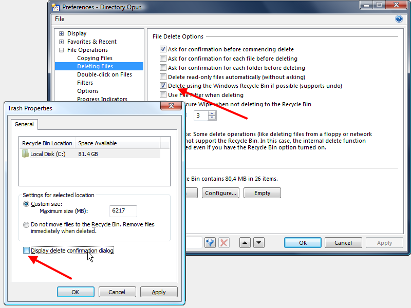

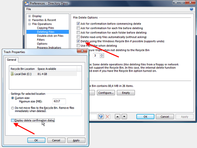

Do you use the Recycle bin? There is a simple way to disable the confirmation box whenever files are moved to recycle bin in Vista: Right-click on the
Recycle Bin and select Properties. You will now see a dialog box with an option to display delete confirmation dialog box.
Yes, that´s right, i use the "recycle bin" setting, in case i accidentally delete something. Otherwise i hold shift while deleting, which will avoid the ryclycle bin. I´m not sure if there´s a setting to force deletion, even when the bin is used.
I also use the Recycle Bin and I don't get the Confirmation Dialog. I use these settings:
