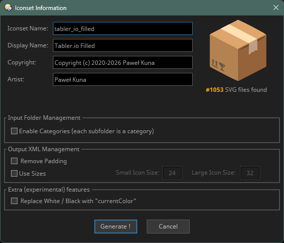

Basic SVG iconset generator
This script addin lets you create an SVG iconset based on the content (individual svg files) of the source folder.
It defines a new command: GenSvgIconSet that you can call from a button, or directly from the FAYT command tool.
It will display a dialog to let you fill in information about the set:
Then it will build the iconset xml by reading and parsing every .svg file in the source folder, creating an icon in the set named after the .svg filename.
Doing so, malformed xml svg will be rejected.
Then it saves the set according to the Iconset Name provided, and generates the .dis file (a zipped version of the iconset xml file).
If you encounter issues, let me know.
Here's the script:
V2.1: SvgTools.opusscriptinstall (11.9 KB)
Enhanced configuration section:
  • Main UI checkboxes and edit fields can be pre-filled with values stored in script configuration:
    • Remove Padding
    • Use sizes and small & large sizes
  • New option introduced in the config: Categories smart triggering:
    • When the tool is launched, a count of SVG files in active folder and its direct subfolders is made. If that option is enabled (yes/true), the "Enable categories" option of the main dialog is automatically ticked if files are found in subfolders (yet still remains to be unticked if necessary).
UI changes / fixes & misc.:
  • Colors to display the number of SVG files found both in active folder and direct subfolders changed to something green (was orange before) when files found, and red when no file is found.
  • If post-processing is activated, a check is made that the provided command name exists in Opus. If not, a dialog is displayed to warn the user, and generation is not launched.
  • Min version raised to 13.23.1 so that the (SVG) logo on the main dialog can be loaded.
  • Fixed: Enabling post-processing in the configuration now properly activates that feature in the main dalog.
  • Fixed: If categories were enabled but not SVG existed in the active folder, an empty category without name was created. It's not created anymore.

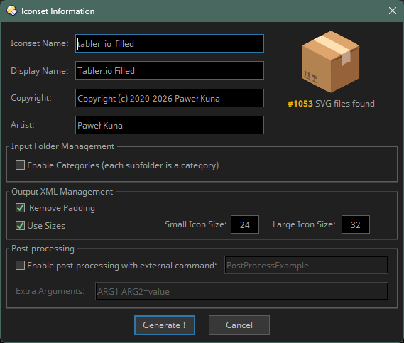

V2.0:
  • New external post-processing feature:
    • This feature can be enabled/disabled by default in the script configuration (default = disabled)
    • The configuration allows you to define an external Opus (probably custom :)) command to be called at the end of the XML building process. Some extra options can also be configured both in the UI and the script config (to avoid having to re-enter them each time).
    • The external command must implement a FILE argument. This argument will be used to give this command the path to the XML file built so far so it can modify it according to its needs. Here's an example "plugin" script containing a couple example commands and also providing a few side functions (read/write xml file as string, read/write xml file as a XML Document).
      SvgToolsPlugin.opusscriptinstall (2.1 KB)
      See https://resource.dopus.com/t/basic-svg-iconset-generator/59623/29?u=passthepeas for a look at the example plugin script code.
    • The external command must write back to XML to the same with it was provided with, so that the rest of the process goes on and the packaging to the .dis file can be made from it.
  • When no SVG file is found: Instead of not opening, the UI now opens and displays in red the #0 count of svg files found.
  • Code cleanup and factorisation
The goal of this external post-processing is to allow anyone to try and apply its own post-processing without having to change the core of the iconset making process.
And anyone not needing this will not have to bother and will just be able to leave things as they are pre-configured.

New UI for introduced options
  • Ability to use some new features (coming from 13.23.7)
    • remove_padding
    • small and large sizes can also be specified (optional)
  • If no proper xml is selected when lauching the GenSvgIconSet command, the name and display name are retrieved from current folder path name.
  • The generated temporary/embedded xml in .dis file is now reformatted to be more easily read (by human)
  • Added an optional experimental feature (use at your own risk) to replace white/#ffffff/black/#000000 in fill: and stroke: attributes in the xml by currentColor.

Thanks to @kundal suggestions and provided code (in PM), here's version 1.4:
SvgTools.opusscriptinstall (12.5 KB)
Changes:
  • New UI for introduced options
    • remove_padding
New UI:
