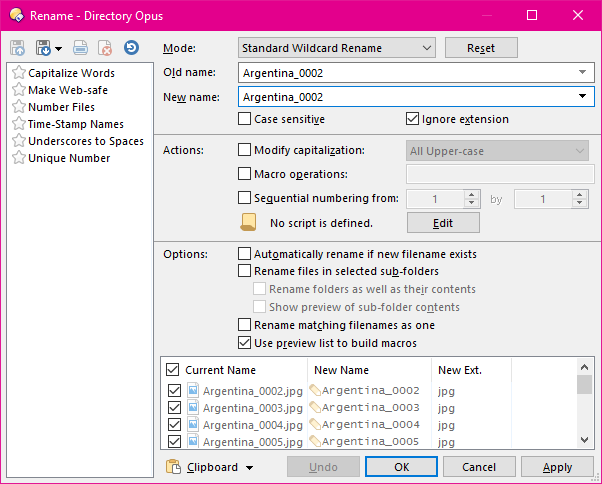

  1. Select the files you want to rename
  2. Click the Rename button on the toolbar (or press Alt+3)
  3. Set rename parameters as needed
  4. Click OK
Step 3 obviously depends on the rename you actually want to do. But it sounds like you actually haven't found the Rename dialog yet, so maybe once you get that far you'll find you can work the rest out yourself.
For reference, it looks like this:
And is fully documented in the manual.

What rename are you trying to do? (i.e. what are the original file names, and what do you want the new names to be?)
Here's an example that might help:
Note that you can use the arrow drop-down on the right of the new name field to insert different things.
And this may not be the best way to do things, depending on exactly what it is you want to do.
I think I have it now. From the example I see you have replaced the old name with a *. Didn't realise you had to do this. Now all the files get renamed. The exif details I can play with later. Thank you for your prompt help.
