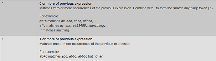

We are using RegEx so the entire string must match.
(\d*) means 0 or more of \d so I mentally process 0 as that is the rightmost judgement I can make.
(\d+) means 1 or more of \d so I mentally process 1 as that is the rightmost judgement I can make.
In these two cases it is then easy to complete the match of the entire string.
All that remains left of the \d groups is (.*) .
So then, "G1: \1 G2: \2" becomes
G1: abc123 G2: and G1: abc12 G2: 3 .
* means "As many characters as possible, zero is ok".
+ means "As many characters as possible, at least one".
According to the Directory Opus Manual :laughing:
