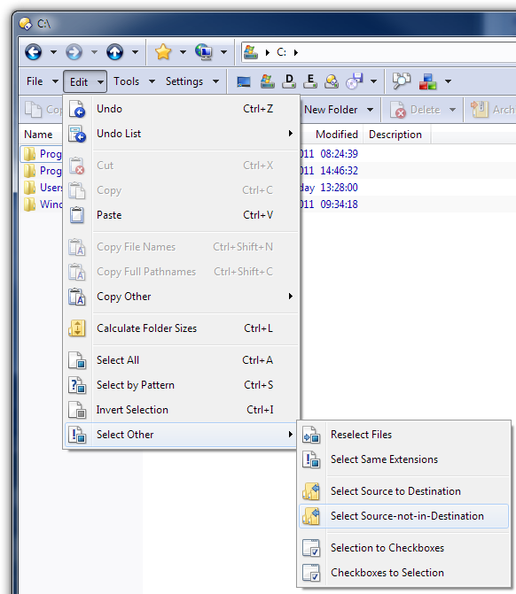

The sync tool doesn't work between collections but if you just want to see which filenames are in one and not the other, use Edit -> Select Other -> Select Source-not-in-Destination.
Hmmmm, I don't see a
It's here on the default toolbars:

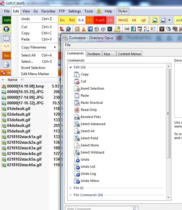

WOW! We must be using very different DOpuses. I'm using version 10.0.0.4.4165.x64. (Just to be clear, from the boys in Austrailia, right? :open_mouth: )

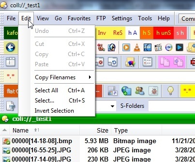

Here's my Edit menu, which looks downright anemic compared to yours:
Over the years that I've had DOpus, I've rarely changed any of the menus, instead making extensive use of toolbars and buttons, so I don't think it's the case that I've somehow deleted a slew of items from the Edit menu. (But who knows?)
And when I go into Customize mode to see what other Edit-menu commands are available for adding to my Edit menu, I don't find any "Select Source-not-in-Destination" command, or a "Select Other -->" item, either. This is all I see:
Sorry to be so difficult. I'm not trying to be. I'm just getting really confused. I realize that DOpus' extremely flexible configuration possibilities can render one person's DOpus radically different from another's. Maybe that's what's going on here?
