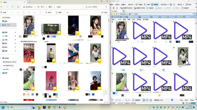

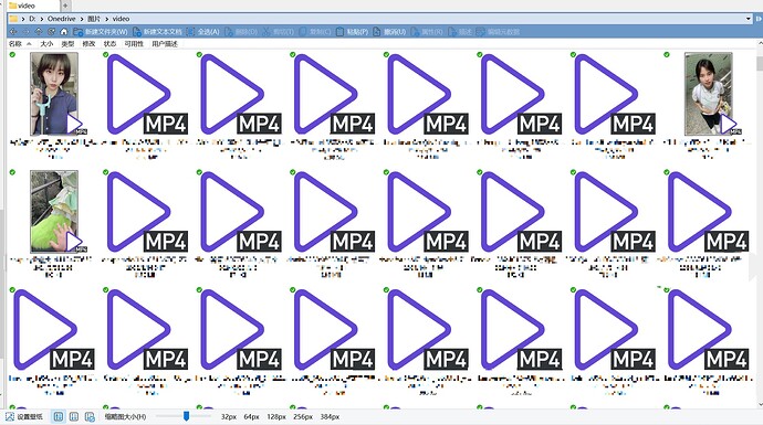

Only a small part of my video files can display thumbnails, but they can all be displayed normally in the Windows 11 Explorer. How should I set it up to make DO display thumbnails normally?

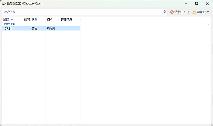

It's also possible that the OS is getting stuck when thumbnailing one of the files, which is then delaying the others from appearing. Help > Task Manager can show what the thumbnail threads are doing. (If you don't have the menu item, get it from Settings > Customize > Default Toolbars.)
After I copied them to a non-OneDrive path, the thumbnails did appear. May I ask what caused this? All the videos in the screenshots I took have been downloaded locally.
