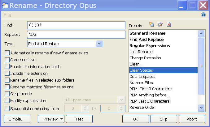

I am trying to use advanced rename "clear spaces" preset and nothing happens. I also want to copy "clear spaces" and edit it to create a preset that clears "_". :question:

Wherever it's from, can you tell us what it looks like, and what it's intended to do but isn't doing?

There are no "copy" or "duplicate" buttons in the advanced rename dialog like there are for similar 'settings' related dialogs elsewhere in Opus. Instead, you can just select the one you want to copy (say "clear spaces"), make the changes you want to make to it, and then hit the "Add" button in the rename dialog... it will SAVE the changes you made to the existing preset, as a NEW preset as long as you specify a different name to save it as :slight_smile:. Otherwise, saving changes to a preset using the existing name of the preset is how you actually "edit" and save changes to an existing preset...

I don't know where this came from. I have never used advanced rename before. The "clear spaces" was already on the list.
Everything below "Last Rename" has been added at some point by you. None of those are included in a new install.
Maybe you imported someone else's configuration at some point.
Change the Type to Regular Expressions.
Change both (.) to (.*)
It should work then.
