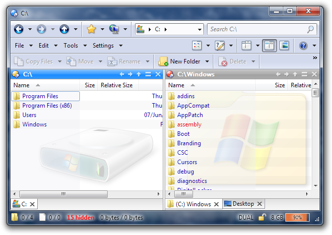

This is a lister (the whole window):

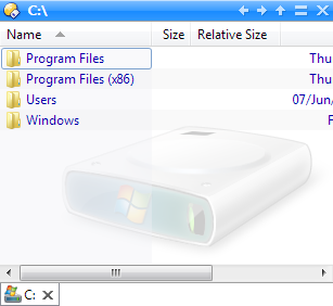

This is one of the three folder tabs within that lister:

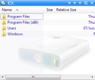

This is the file display within that folder tab:
