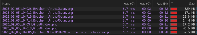

Mhh, these two Columns from the "Generic-Age" script still seem to work for me (first Age column in screenshot).
My own columns though, in that "ModifiedWithin" script, seem to show some weird numbers now, which I cannot make any sense from. Not sure which set of columns you are referring to, I guess the first one, but in that case I can't help. I don't run Win11 yet.. and probably won't for quite some time.

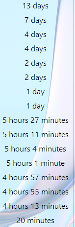

If anybody has an Evaluator for "Age Column" which handles "less than one day" by using "hours" as a unit and BOTH variants (since creation and mofication).. please post, I think I keep that script version otherwise.
Can hack this one.

Thanks! o) Such an evaluator column seems to be much faster than a script and it also does not lazy load values, am I right? Very interesting, this was the first evaluator column I tried, the performance difference is really remarkable, but you can't do all columns as evaluator and I guess you also should not.

Here is another one using evaluator.
