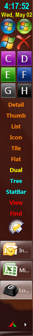

Here is what I am currently up to.
I have combined all my Opus Toolbar commands into the Windows 7 TaskBar (SEE: attached JPEG). Everything runs just great there EXCEPT Opus Menu items such as the yellow Opus shell icon & the round green Windows flag... they won't load my custom menus so I need to do it with HotKeys. That is why I am interested in this topic (plus the BIG red X as mentioned before).

Okay, your Start Menu / Taskbar / Toolbar / etc. project(s). There's a big screenshot of it just above.
It's getting confusing as someone browsing the forum is going to see all these threads/screenshots and think that is what Opus looks like or does, when it's quite a niche aspect of Opus and has been highly customized. (Or in the above case isn't even Opus, which confused me at first as the screenshot looks very similar to the toolbar you posted in several other threads. If I'm getting confused about what is and isn't Opus, other people definitely will be.)
