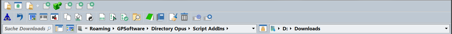

No problems with columns here. I think you mean toolbars:
My Standard toolbars (1 Button Group)
After applying your script command:
Two Button Groups:
