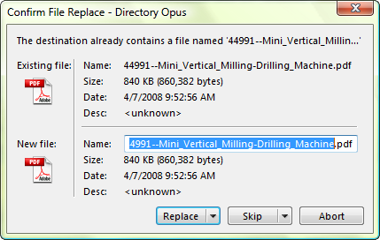

I have a button with the commandCopy DUPLICATE FILE AS * WHENEXISTS=askwhich gets occasional use. It is described as
Copy selected file in same folder, and rename
I don't know when it stopped working, but I can say that it no longer works in either of my Vista and XP systems. It just does nothing.
I'd appreciate it if someone could give it a try and advise whether it works for them. I can confirm that it definitely did work originally.

Copy DUPLICATE FILE AS * WHENEXISTS=ask...doesn't make much sense to me so I'm not too surprised if it isn't working consistently.
If you want to create duplicate files in the same folder then the standard command (right-click action on the Rename button by default) is just...
Copy DUPLICATE

I don't know if this is relevant, but see [Apparent problem with Copy command in 9.1.1.8)[/quote]Thanks everyone. That was the answer. I have installed the newer version of DOpus, and it is working again, but...
[quote="leo"]If you want to create duplicate files in the same folder then the standard command (right-click action on the Rename button by default) is just...
Copy DUPLICATE[/quote]is an even better solution.
