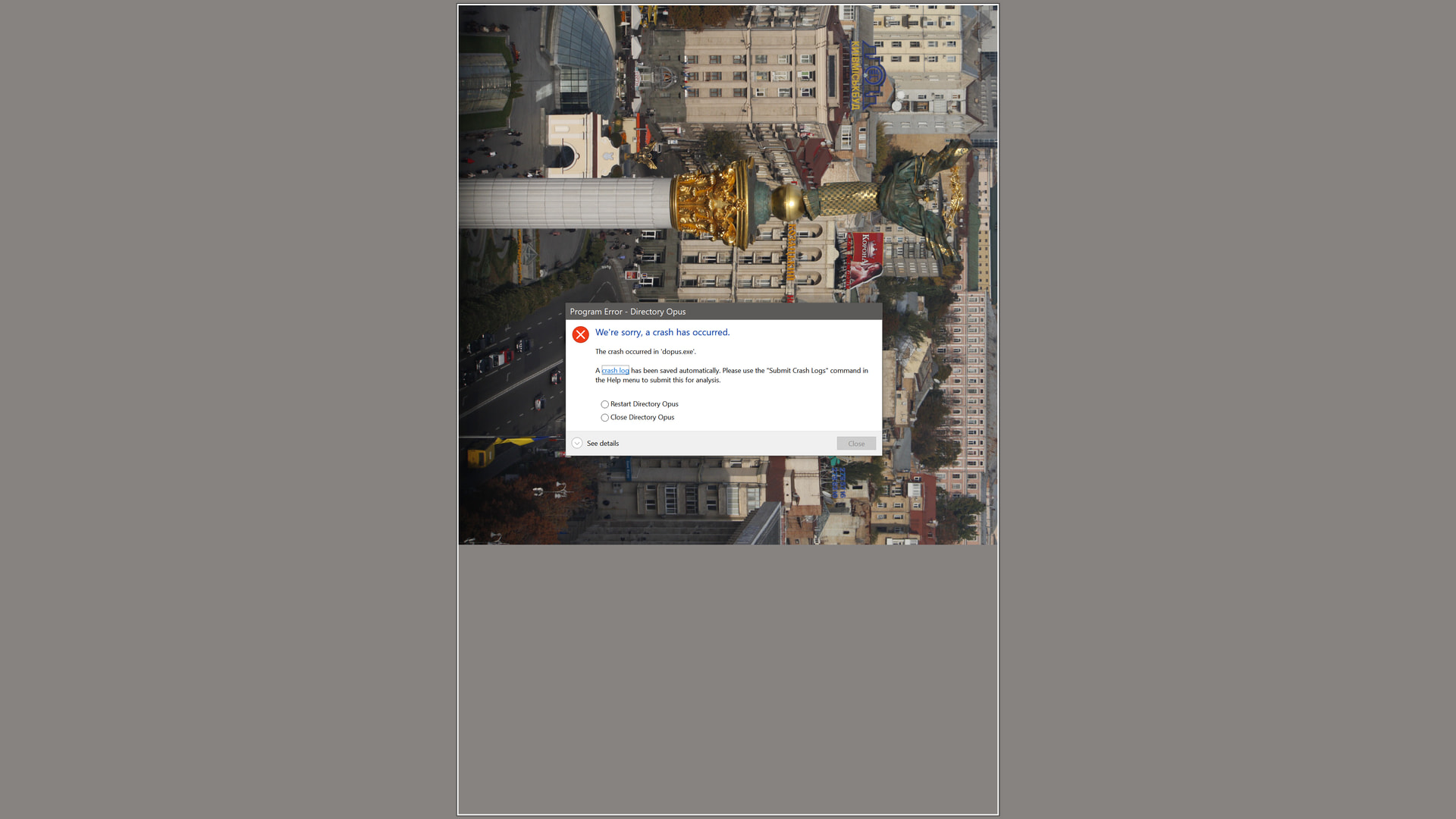

Any .cr2 file with portrait ONLY orientation crashes Opus. Landscape pictures opens well. Thumbnails are OK for all files (portrait and landscape).
I just literally double-click the image and it crashes immediately, no crops or something.

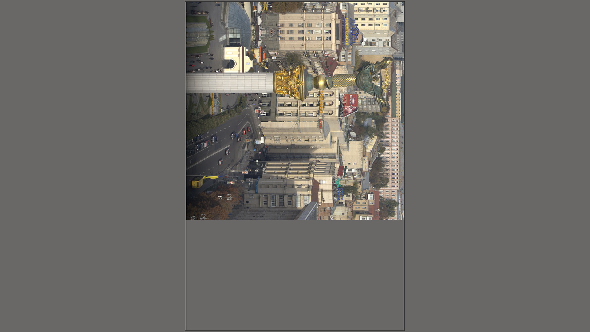

opens as it:
Works fine here, like all my own .cr2 images in portrait.

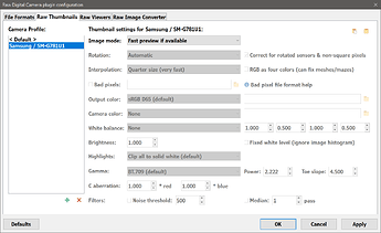

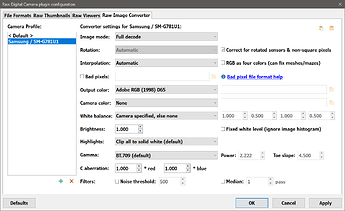

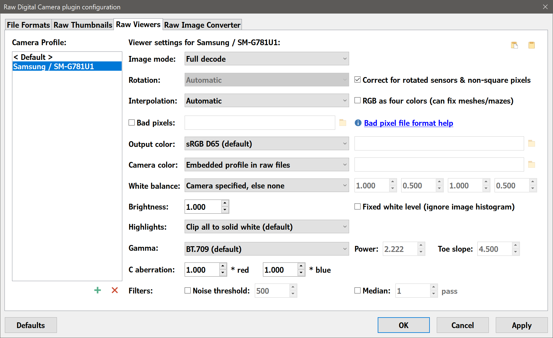

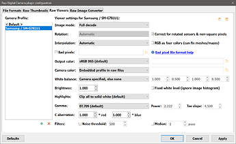

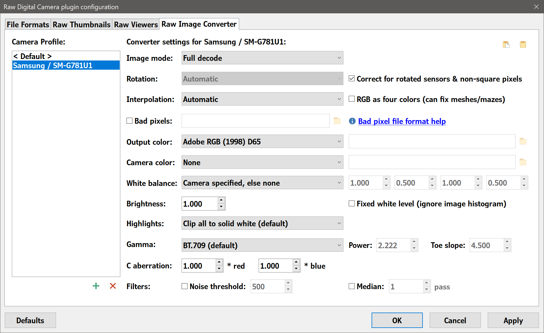

Could you also paste the settings for the Raw Digital Camera plugin (Preferences / Viewer / Plugins) from the Raw Viewers page?
Also, do you have any scripts installed that modify the viewer in some way? The crash itself is in a function that shouldn't even be running immediately after the viewer opens, which makes it look like you might have a script that's doing something in response to a new viewer being created.
that's it (same crashes after changing to "Default")
Sorry, what do you mean by "after changing to Default"?
I tried copying the settings shown in your screenshots but no crash :frowning:
in screenshots a profile is "Samsung..."
changing to "Default" profile doesn't help in any way
p.s. 13.22.2 opens well (sometimes, 2 of 3), 13.22.3 crashes.
13.22 stable doesn't crash

The weird thing is your thumbnail shows that the image data hasn't been rotated (the image itself is landscape, but its orientation tag is set to make it portrait), but the image dimensions have (which is presumably why there's a blank area at the bottom).
This is what the image is supposed to look like:
And this is what it looks like without EXIF auto-rotation turned on:
I can't work out what could cause the image dimensionts to be rotated but not the image data itself, but I'm assuming whatever's triggering it is what's causing the crash you're seeing.

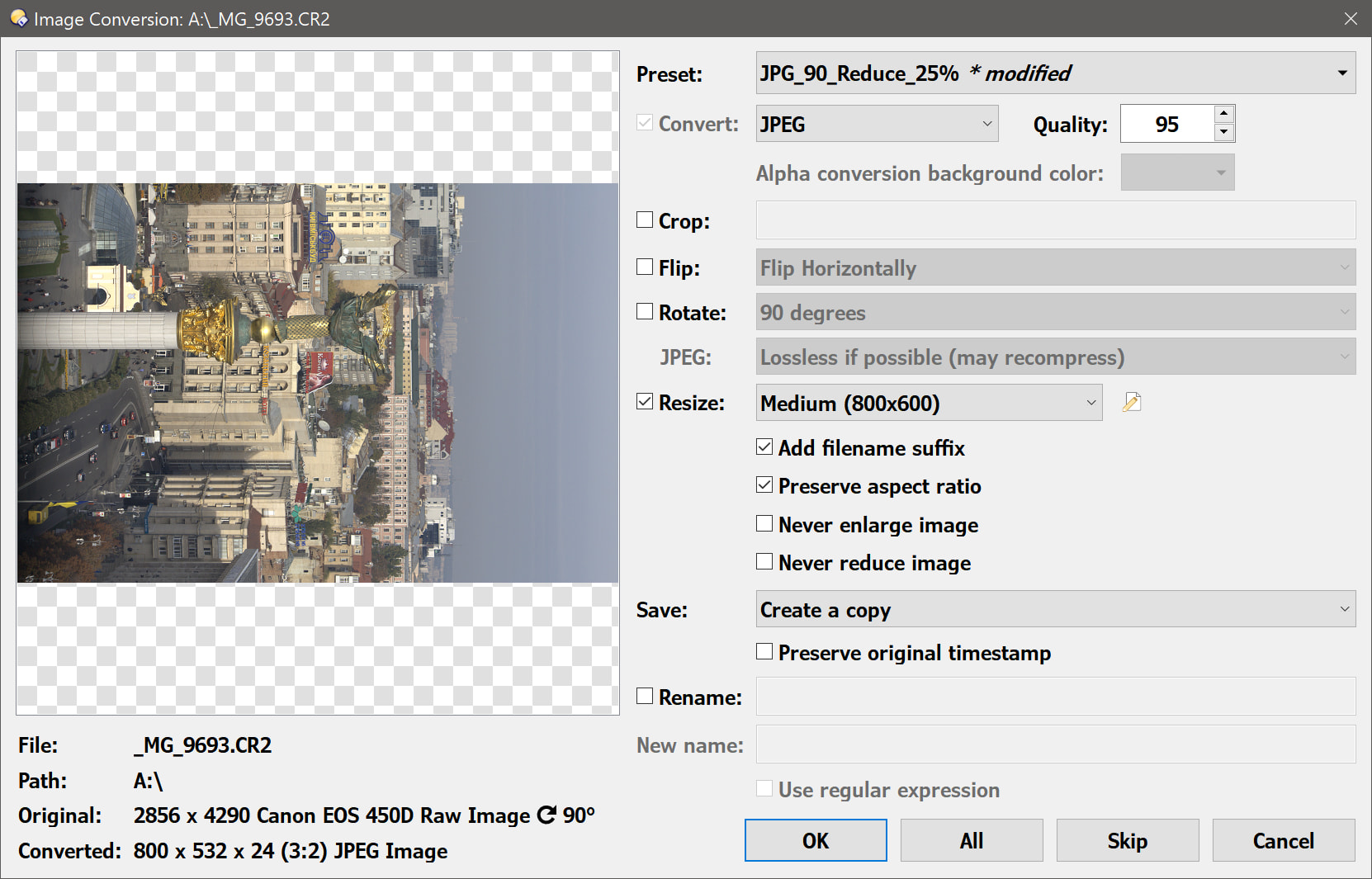

this is an image converter preview of .cr2
and this is a convertion result (jpg opens without crash):

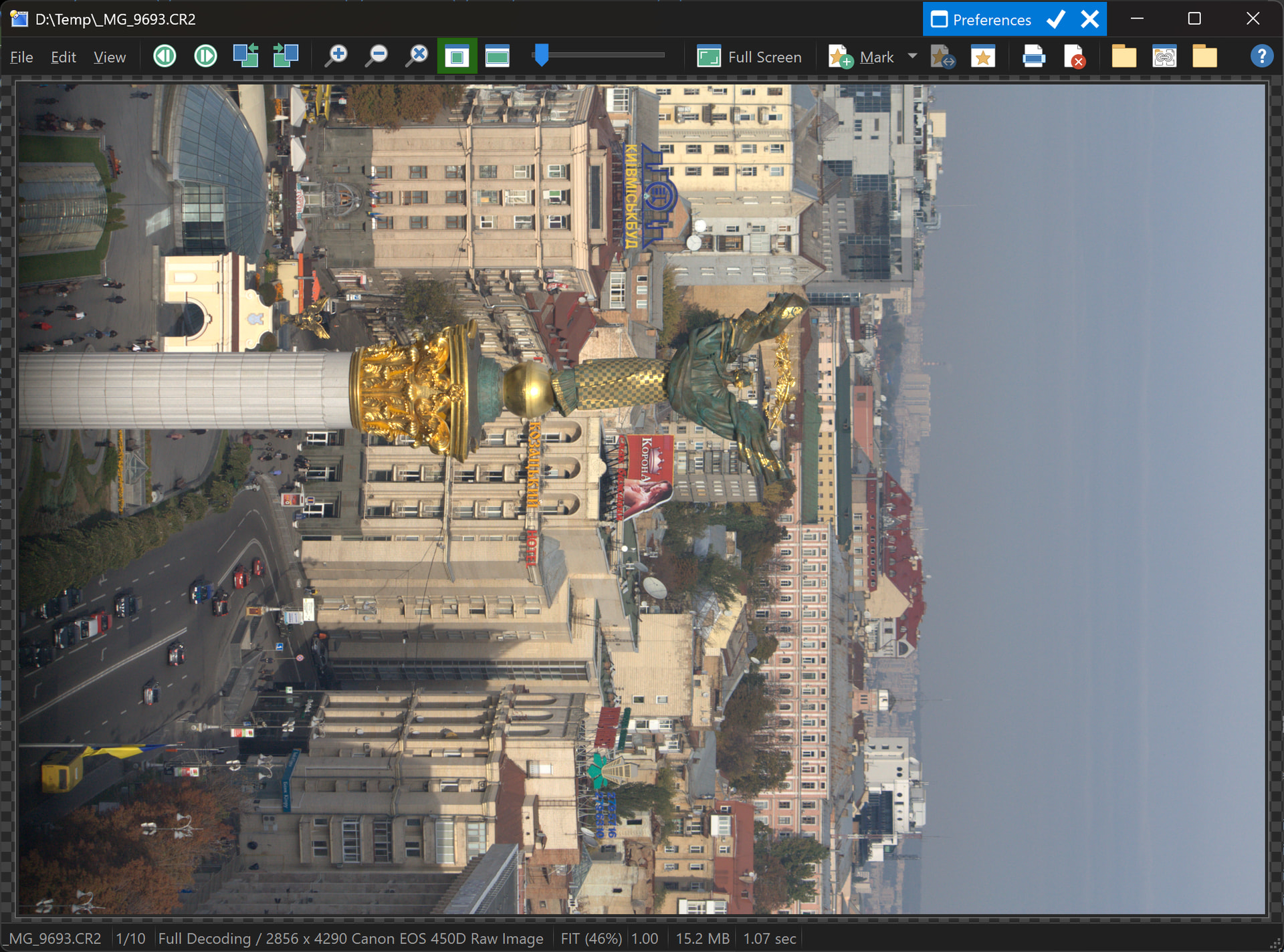

any other soft opens well (Photoshop, XnView, even PDF XChange)
and yes, without auto-rotation .cr2 opens in Opus well, but landscaped.

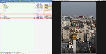

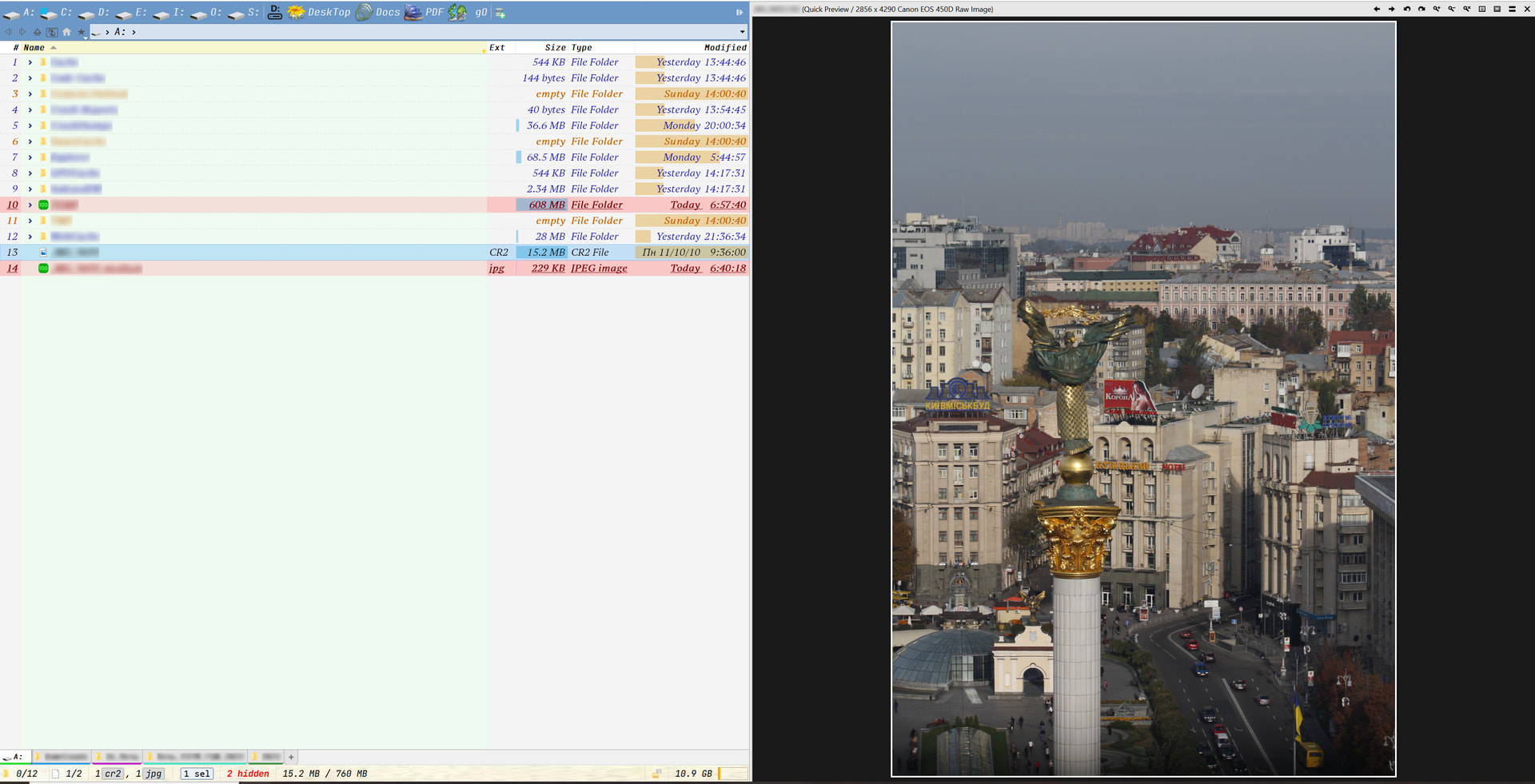

thus .cr2 opens in viewer pane (looks well without any crash):

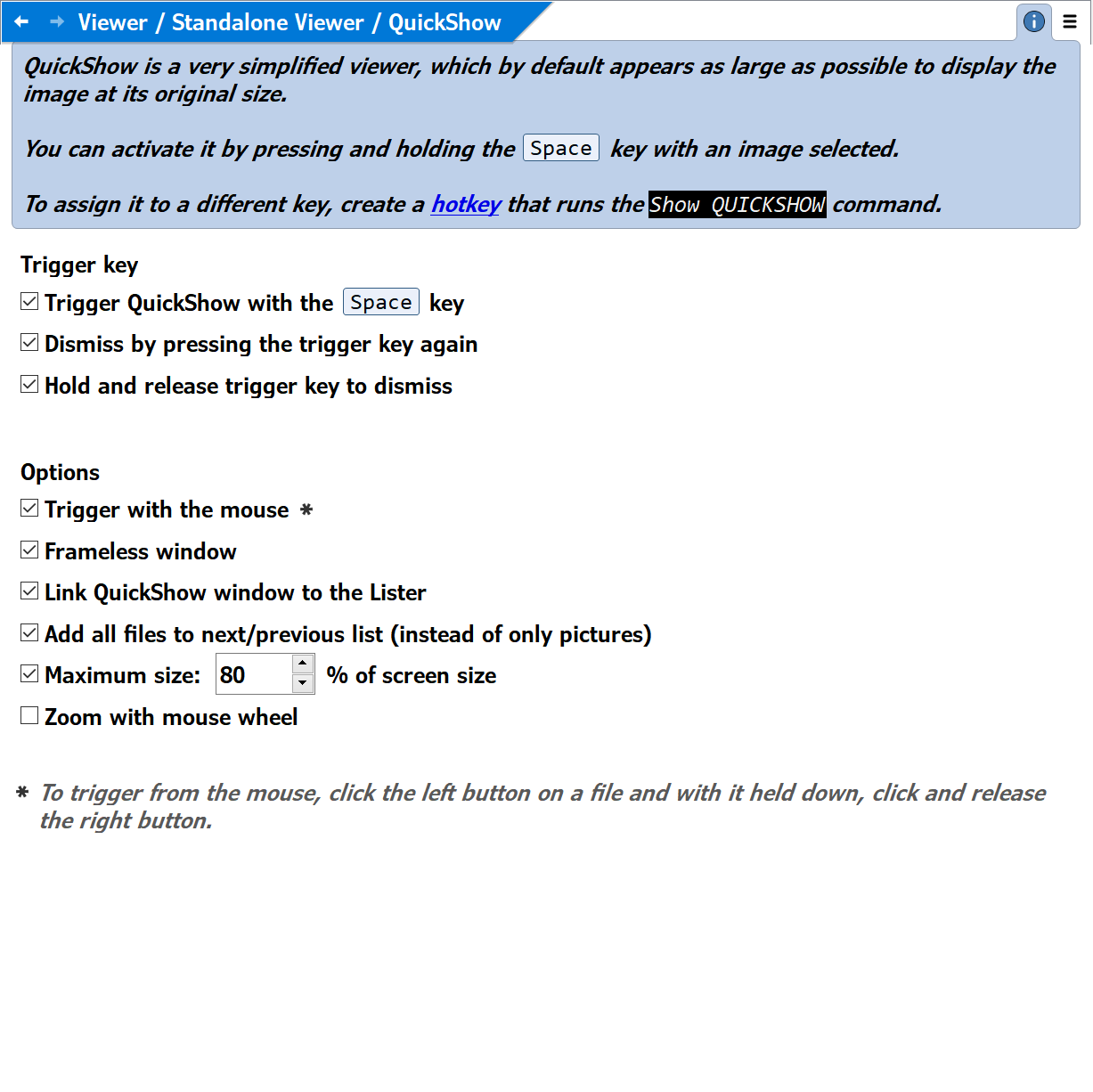

(and another issue with Quick Show was that some images only showed a black area).
