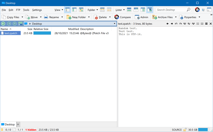

I compiled the code I posted above and it works OK today:

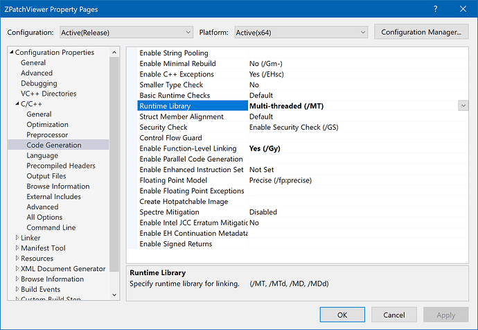

The only change I made was to switch it from using the static C runtime (since I'm using VS2022 and don't have the new CRT DLLs on the machine I was testing on):

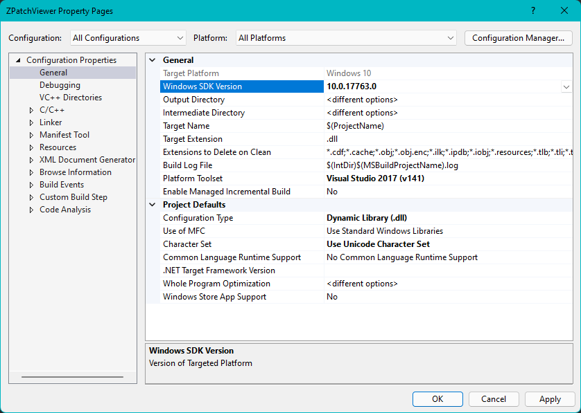

  3. Edited the properties of the project, since the given Windows SDK (10.0.15063.0) isn't installed here. I changed it to 10.0.17763.0:

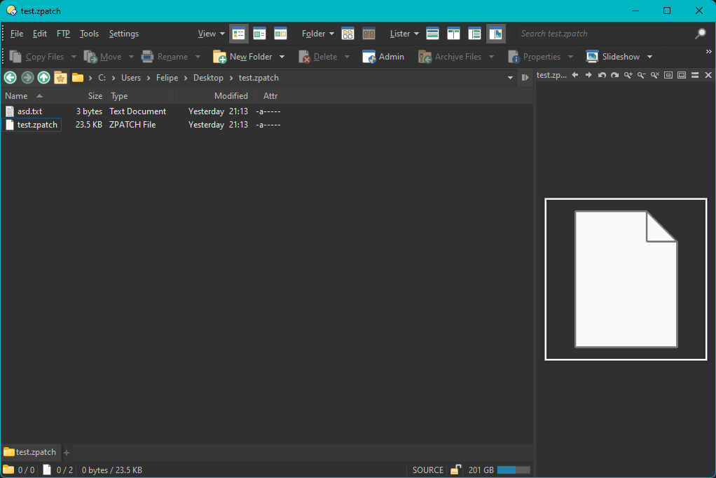

  4. I select a zpatch file and get this:

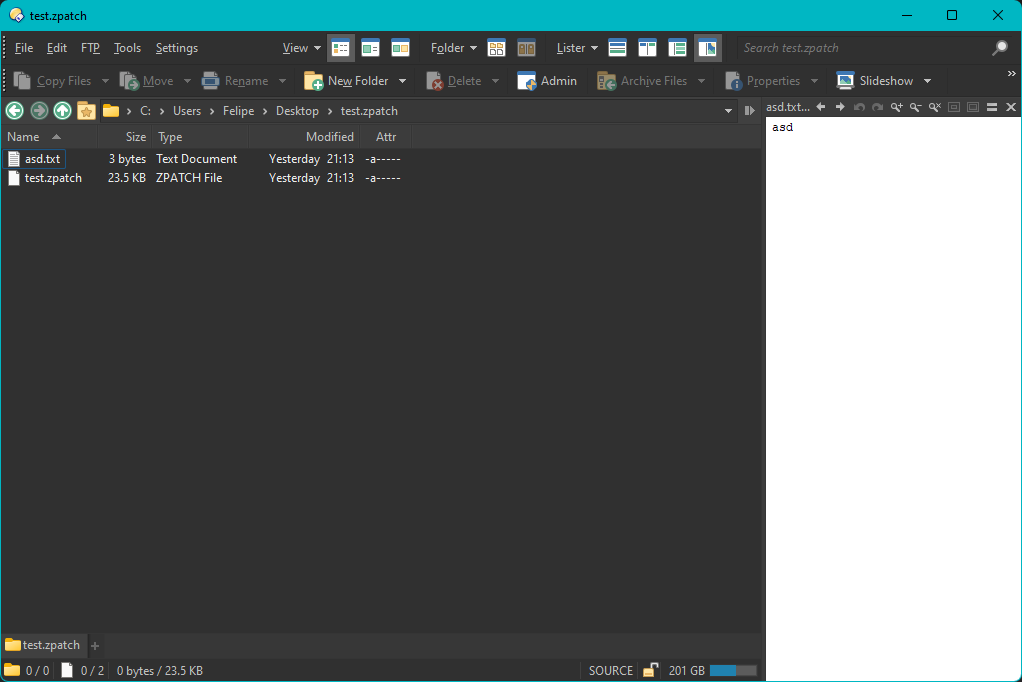

  5. Just to be sure, I try the same with the .txt file I created to test:

Does turning off Preferences / Viewer / Viewer Pane / Display shell icons make a difference?
Unfortunately, no, same behavior :frowning:
