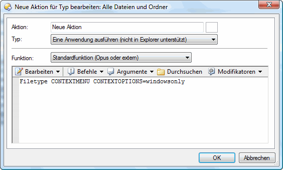

Searching the forum I've found this command:
Filetype CONTEXTMENU CONTEXTOPTIONS=windowsonly

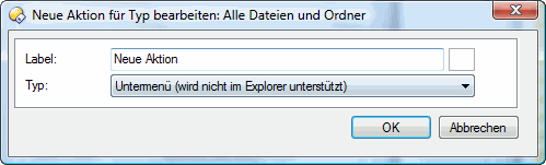

But when I try to create a sub-menu in the context-menu for all files and folders I see no field to enter the above command:
Change the Type.
Jon, the Type displayed in the image "Untermenü" does mean 'sub-menu'.
When I select the Type "Eine Anwendung ausführen" (english: Execute an application) then no sub-menu is created and the Windows objects are again displayed in the main context-menu (although the setting to hide them is activated in Prefs):
You need to add a sub-menu first, and then put your Filetype command in that sub-menu.
[quote="PeterPanino"]Searching the forum I've found this command:
But when I try to create a sub-menu in the context-menu for all files and folders I see no field to enter the above command:[/quote]
It took me a while to figure this out recently. You have to do it in two steps.
I assume that in what you have shown "Untemenu" is sub-menu. Go ahead and create that just like it is with no command. (Maybe chenge the label).
Then you will have a sub-menu showing up in the editor. Now create another entry containing the command under this sub-menu entry.
OK, I got it now: In the dialog, create a sub-menu item first, and then add a command item to this sub-menu item.
