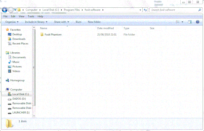

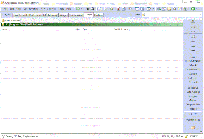

Can you post screenshots of both Explorer and Opus showing the folder in question? That would make things easy to see.
It's the folder of an installed software, as can be seen in the screenshots.
DO doesn't show the folder Foxit Phantom, which has several different extension files in it, and it doesn't associate pdf files do Foxit.

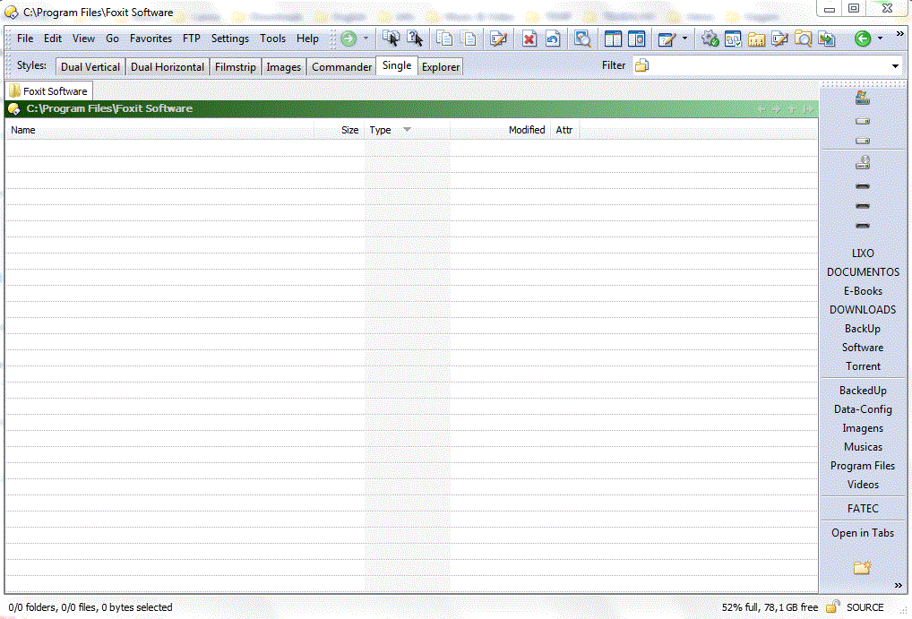

  1. Here´s what happened:
  2. I put the .dcf file in the foxit directory, double clicked, nothing changed.
  3. All processes running as the same user.

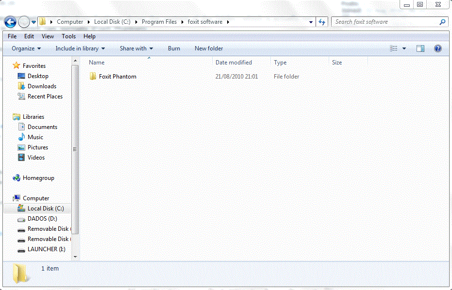

Command prompt:
There are no * next to programs in task manager, and I have many 32 bits programs installed.
That screen is for DO Portable running.
