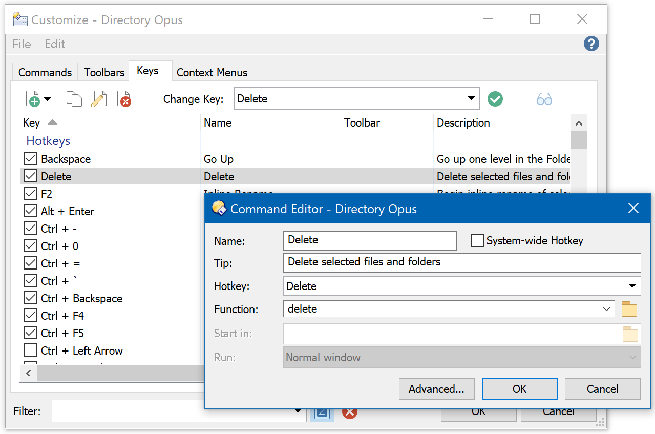

What do you see under Settings > Customize Toolbars > Keys?
The same menu, but with Delete in red (like other entries)
That means you have multiple hotkeys assigned to delete.
Based on what other people have done before, my guess is you have turned the Image Viewer toolbar on in your main lister windows. Turn it off, as it only makes sense in the standalone viewer.

In fact it's on, and grey: how to turn off ?
If it's on, you should still be able to turn it off via Settings > Customize Toolbars. At least, I can from a quick test.
Where are you seeing it grey? Could you post a screenshot?
You should also be able to right-click an empty area on the toolbar itself and select Close to close it.
Once it has been closed via one method or the other, remember to use Settings > Toolbars > Set as Default Toolbar Set to save your current toolbars as the new default, otherwise new windows may continue to use the old ones.
