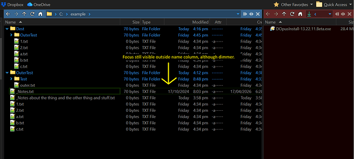

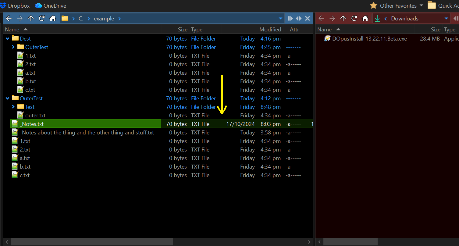

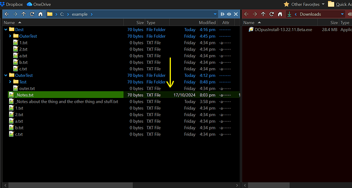

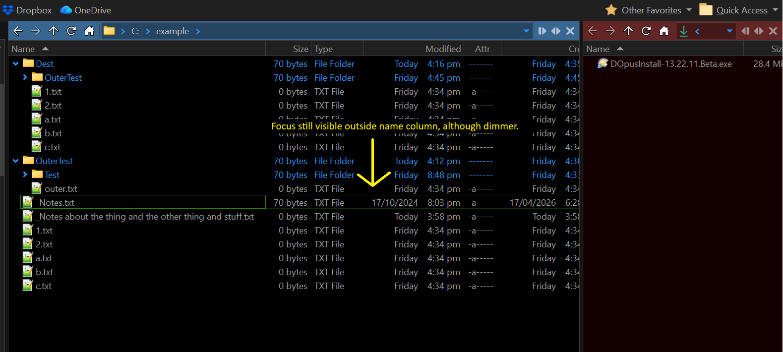

So my suggestion is for a way to change the "selected background" color and focus outline color of the selected or focused row separately from the Name column. So that the Name column looks the same as when option 1 above is on and option 2 above is off, but at the same time the other columns in the currently selected row can have a selected background color and focus outline color which is visible but a lot dimmer, for example 30% of the opacity of the Name column's selected color.
It might be better to explain with mockup images of what I'd like to be achievable:
Selected background colour for non-Name columns: (image)
Focused outline colour for non-Name columns: (image)
