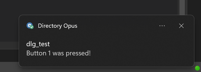

It works ok here...

Should be fixed in the next beta. I was able to reproduce the problem on one of my machines.
Thanks!
