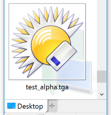

If I load a PNG into Photoshop, save it as a TGA (choosing 32 bpp), then load that back into Photoshop, the alpha channel is gone, without involving Opus at all.
You have to jump through some hoops to get Photoshop to save a TGA file with alpha. You need to explicitly create a fourth channel and fill it with grayscale data before saving the image. Even then, Photoshop still won't use that channel for transparency after you load the TGA back into it; Opus will, however.
So your issue is probably not with Opus, but with what is creating the TGA files, with the added confusion that Photoshop doesn't really seem to support alpha in TGA (even if it can be tricked into saving it).
test_alpha.zip (80.2 KB)

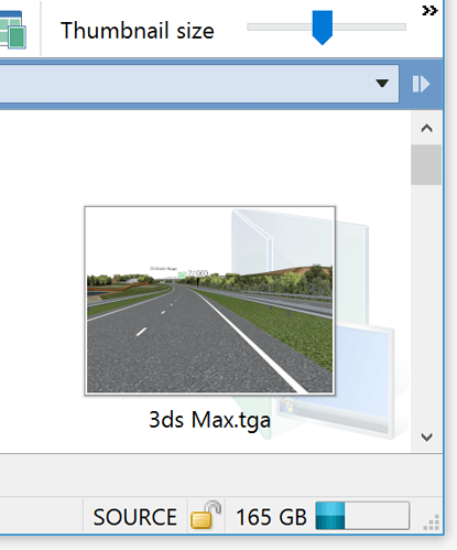

In that case, the image IS displaying correctly, as yours does, but in my case the alpha channel is part of the image.... if that makes sense - it should when you see it.
Thanks for the info Leo, but it looks like everything is working as expected?

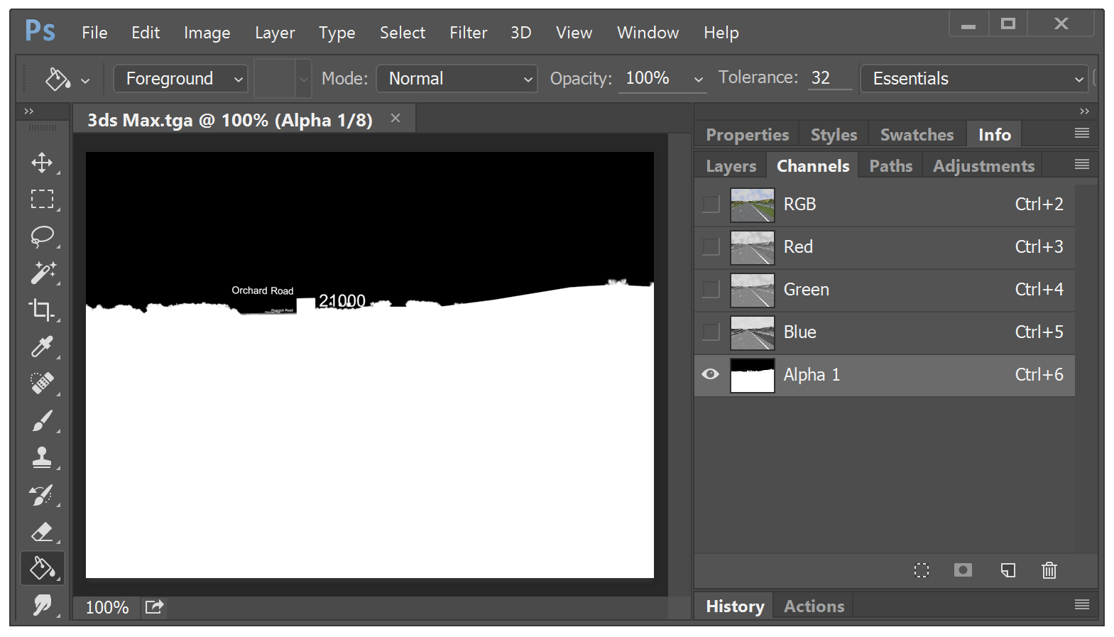

3ds Max.zip (741 KB)
That file seems correct in Opus, here at least.
Looks correct based on what Photoshop shows is in the alpha channel. (Photoshop calls it the "Alpha 1" channel, since Photoshop is not interpreting it as the alpha channel but just as a generic 4th channel after the R,G,B channels; it would call a 5th channel "Alpha 2" and so on.)
