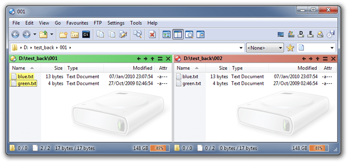

While testing one backup strategy I run accross a problem. I copied some test files from one folder to another and noticed that Directory Opus changed the date of last modification of one file to "now" after copy. See the image - it's the "blue.txt" file that Opus modified. The other file ("green.txt") was copied without any modification.
I tried this procedure in Windows Explorer and it copied both files without any problem. It didn´t altered the date. Again, see the image.

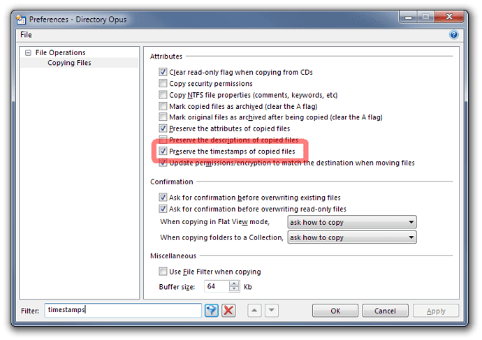

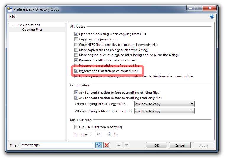

Check that the option shown below is on, too:

I have the "Preserve the timestamps of copied files" turned on.

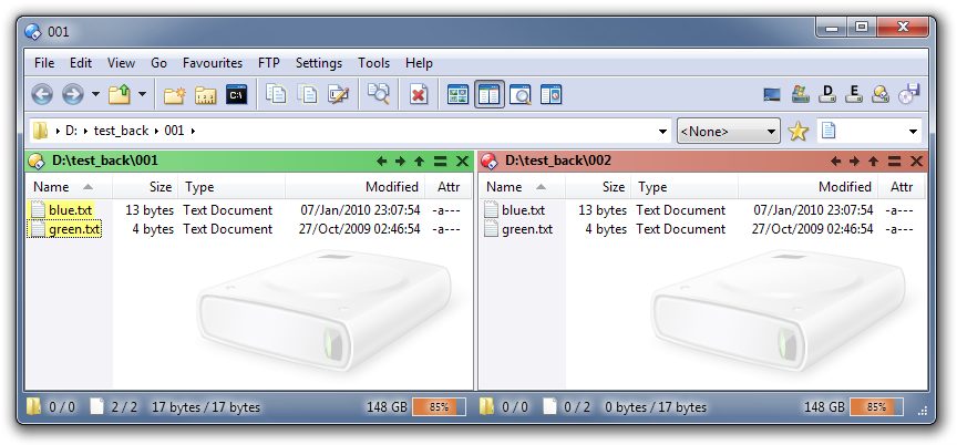

I can't reproduce it:

I set the date on the file myself so the test was as close as possible to what you were doing.
