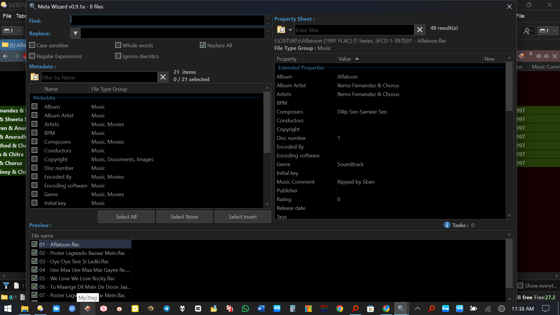

Out of curiosity: what it does (or is supposed to do) if "Regular Expressions" is not checked?
If I enter * in "Find:" field then the current values of selected metadata are displayed, no matter what I type in "Replace:" field and which other options I enable.
It will be treated as a literal string.
Find and Replace fields are for, well, find patterns and replace them among the selected properties.
You can use regular expressions (like .*) by checking the corresponding control. (The published version doesn't have support for DO wildcards)
If no replacement is made (e.g. when you're trying to replace an actual *, which assume doesn't exists in the current value), the preview shown will be the same as the original value.
