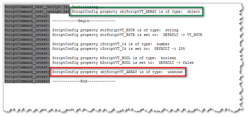

In the interim, consider the sample test script attached to this post... and the results from running the command it adds to Opus (Test_JScript) from a button:
ScriptCommand_test_jscript.zip (1.74 KB)
The log messages show that during OnInit, I'm able to get a valid type for the initData.config.objScriptVT_ARRAY property after assigning values to it as an array.
...but then once I reference them after initialization, the type for the property has been lost. Even then, maybe I'm doing something wrong in how I'm referencing the property, but I'm not sure what else to try.
Once again, I get that some things are still being sorted out and what-not... I'm posting here as I learn more to illustrate what I now believe is an actual issue, and not just a result of me mis-using JScript syntax or object reference conventions.
I think there's actually in your JScript scripting host implementation with respect to how this property is implemented/imported when used as an array, whereas it actually works BETTER than fine in VBscript. Based on some issues I was googling about when first running into this problem, I wonder if you're doing some kind of typeof operation on the ScriptConfig properties when you import them since you allow the single property to be used as multiple types... but anyway:
I've whittled down my test scripts a little bit and dispensed with the global variable stuff I was playing with for control testing. Please consider the following test results:
JScript example:
ScriptCommand_test_jscript.zip (1.18 KB)
...as before, in JScript - you can see that between OnInit and referencing the property in the ~main script function - the data type has been lost. I added checks into the test scripts to avoid the 'Script.config.objScriptVT_ARRAY.length' is null or not an object (0x800a138f) error that gets thrown if I try to loop through the values that should be in the array.

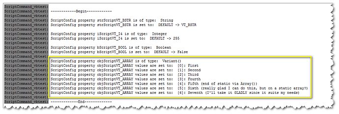

Now compare that to the results of an equivalent test VBscript:
ScriptCommand_test_vbscript.zip (1.21 KB)
...lo and behold, the data type is preserved between OnInit and being referenced in the scripts ~main function.
But what's even cooler (in my mind) is that when working properly in VB, it's also actually ALREADY working exactly how I had requested earlier... such that users can add their own strings to the array (not just modify array elements defined in the script). The array was even declared static, with an initial size of only 5 elements... so I guess on import you're probably copying the array values into a global dynamic array to make available to all script functions (THANKS for thinking of that) and I wonder if something in your checks before doing so are what is going wrong in JScript?
