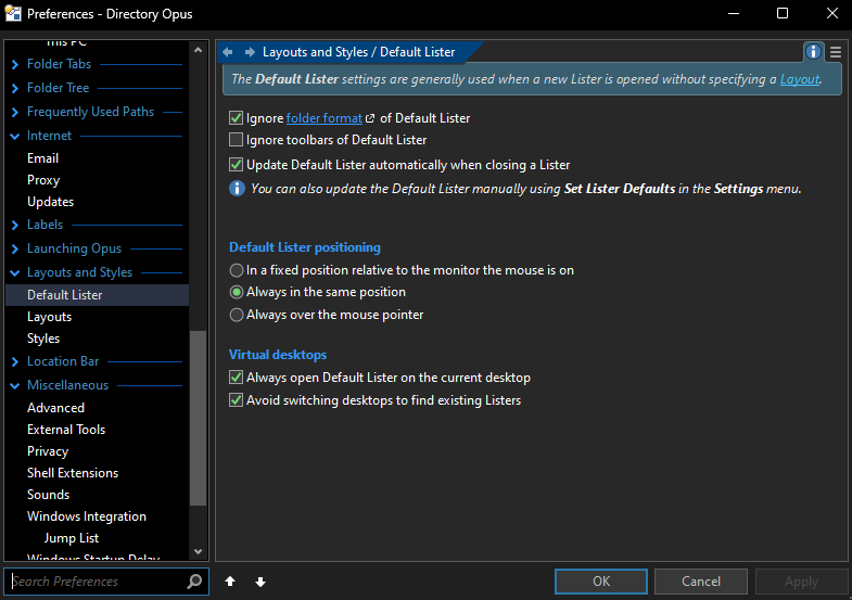

I DO have "Update Default Lister automatically when closing a Lister" checked in "Default Lister" in Options.
Now that out of the way, for a while now, each time I boot my computer back up in the morning at work, DOpus opens with Windows in the "Internet folder". Tiny screenshot below.

The settings under Preferences / Launching Opus / Startup are also (more) important when the problem is with restarting.
It can also depend how you are starting Opus.
13.10 is almost a year old so updating it would make sense.

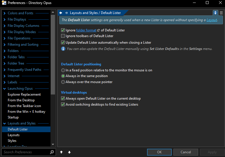

These are the current settings:
And when I opened my computer this morning, it still opened to this:
Note: if I close the lister, close the process, then re-open DOpus, the last tabs I had opened (for testing) are the ones showing up. The same happen if I just close the process without closing the lister first. This only happens by shutting down the PC and booting it back up.

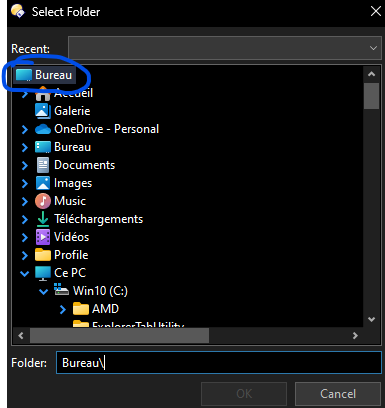

The folder that I've circled above is the folder that actually appears... the "Internet" folder. It's just "Desktop". But you can't add that to the list as you can see with the "OK" button being greyed out.
Try dragging the path, via the icon at the left of the path field in the main window, into the list in Preferences.
