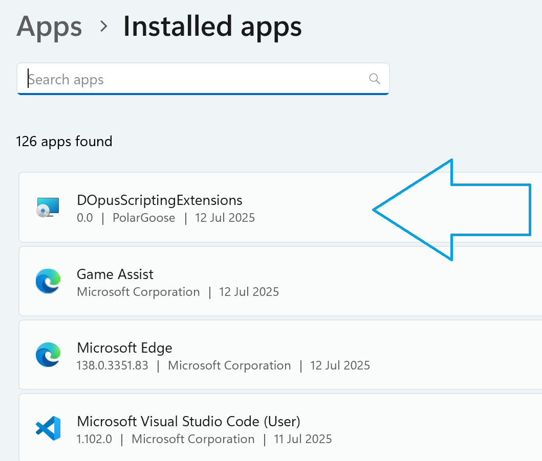

I like transparency. But I could not find your extension under "Miscellaneous > Shell Extensions" in DO's Preferences. Or am I looking in the wrong place?
You can see it in the Apps & Features Windows menu, and you can uninstall it from there:
You can't see it in Directory Opus because it is just a COM DLL. Directory Opus doesn't know anything about it, unless you use it from your scripts.
