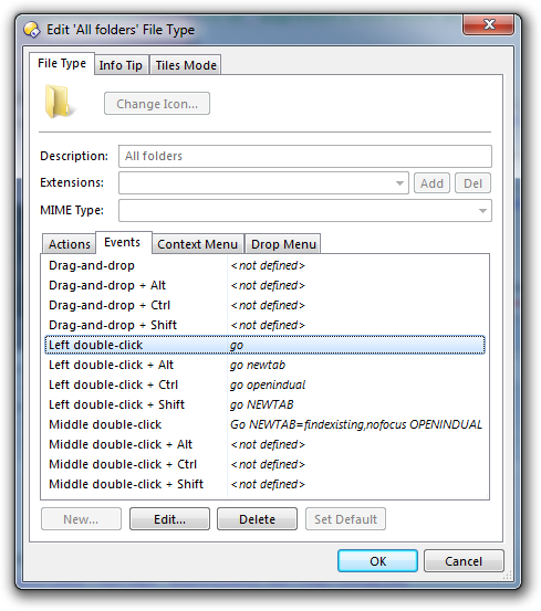

Go to Settings -> Filetypes and open:
[ul][li]All files[/li]
[li]All files and folders[/li]
[li]All folders[/li][/ul]
Go to the Events tab in each of them, and look at the Left double-click event.
[ul][li]All files:[/li]
[li]All files and folders:
In both those cases, the Left double-click event should say < not defined >. If it doesn't, select it and delete it.
[/li]

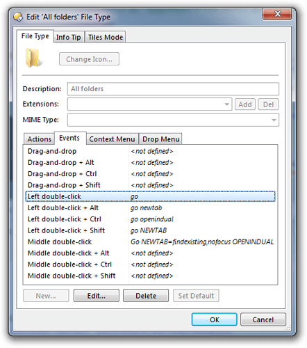

[li]All folders:
The Left double-click event should say go[/li][/ul]
