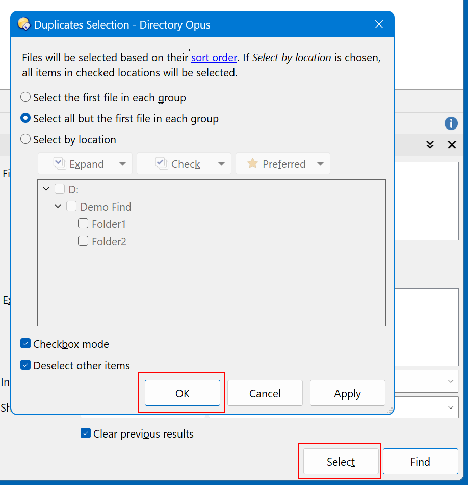

Duplicates Selection dialog: no focus on ok
The OK button in the Duplicates Selection dialog has focus when the dialog gets called via click on the Select button in the Find panel.
It does not have focus when called via the accelerator key (Alt-t). In that case, the only option to okay the dialog is to click OK.

In 13.0.48, this works as expected if the results are shown in the destination.
If they are shown in the source, the focus is on the source, and the only way to bring it back to the panel to use the accelerator key is to close and re-open the panel. After selecting files through the dialog, the panel needs to be closed again to bring the focus back to the file display and be able to e.g. delete files.
