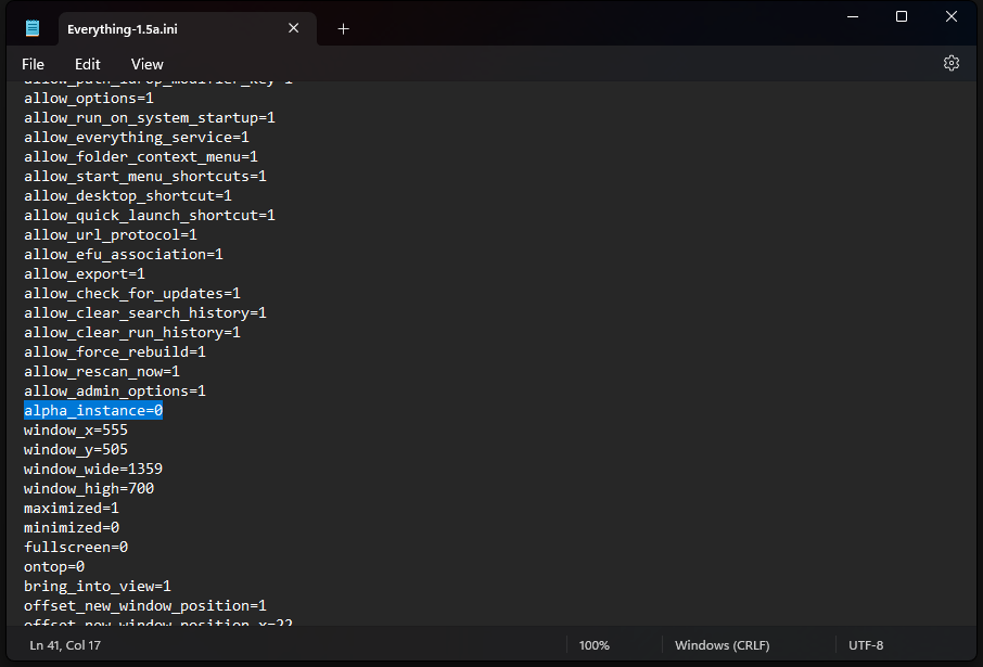

Still no success. :thinking:
And here.

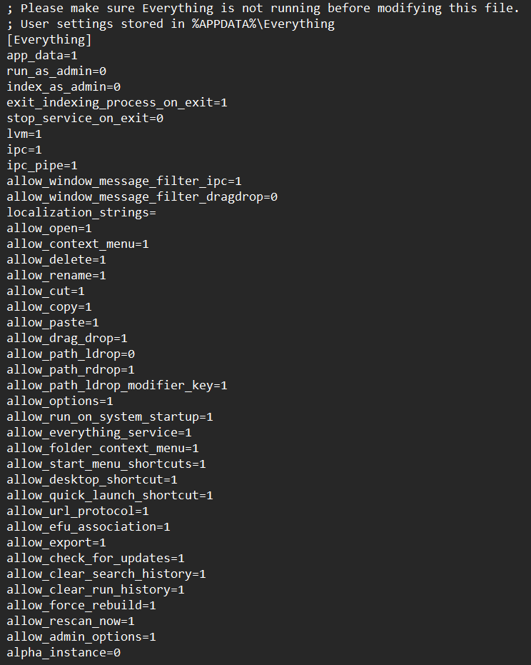

Yes, i had checked that, of course, but the ini looks different here. That shouldn't make a big difference, though.
already set. Problems with some folders! Not all

download the LAST version of es.exe, that was my trouble when i got zeros.
!!! as Leo says: Everything.exe and es.exe are not the same

Edit: the latest es.exe did the trick, got it working now! Thanks, lxp, and thanks guys!

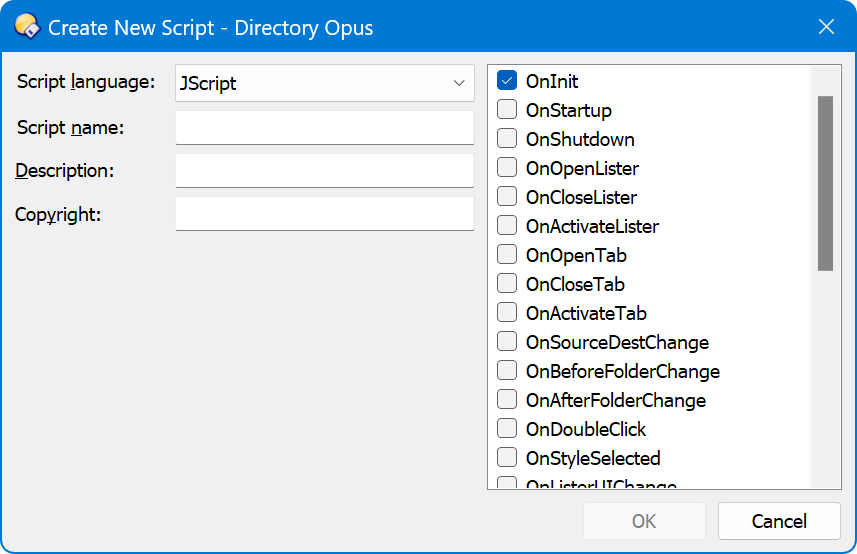

In which situations would you benefit from an auto-refresh? It can't be as comfortable as the updates the file displays provide when files change, because scripts are not part of the internal communication system (this would also be a performance problem). We would need to pick an additional event to trigger the refresh. Candidates are OnActivateLister and OnActivateTab. See here for a complete list:

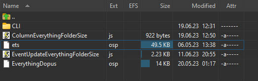

a column EFS is shown in the lister, but the column EFS ist empty:
2023-06-19 12 56 27

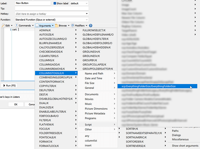

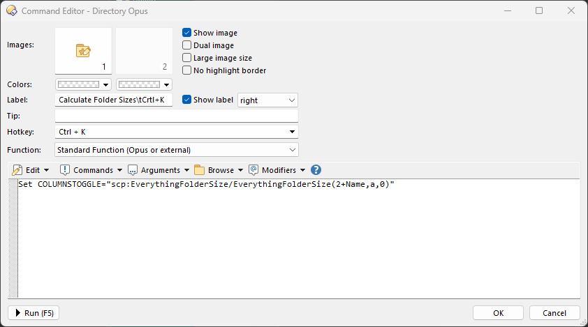

It would be also great if somebody could explain me the following code:
Set COLUMNSTOGGLE="scp:EverythingFolderSize/EverythingFolderSize(2+Name,a,0)"
specially the part scp:EverythingFolderSize/EverythingFolderSize. I don't understand the meaning of scp: and the slash "/" ind the string. As far as I understood, it does not match the documentation given in Documents/Set.htm.
I assume that "EverythingFolderSize" is the name of the column in the Lister. If I change the name of the column, do I also have to change it here?

That's Opus standard notation for script columns

I did the following steps:
  1. Deleted the old files in ...\AppData\Roaming\GPSoftware\Directory Opus\Script AddIns
  2. Download the files from your first post
  3. Copy the files .. \AppData\Roaming\GPSoftware\Directory Opus\Script AddIns
  4. Delte the extension .txt
  5. Restarting DOPUS
  6. No Script Output messages anymore
  7. Click on the button shows a new column EFS in the lister, but complete empty
