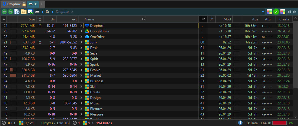

It is weird that it is working in the Dropbox folder and its sub-folders. It is working in the Downloads folder but not in its sub-folders. I could not find any other folder it is working in.

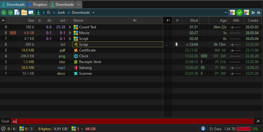

Can you paste an example screenshot, so we can see what was typed and which files/folders are visible?
It got more interesting when I took the screenshots...

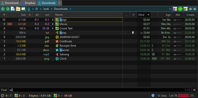

A) Worked in 'Downloads' folder':

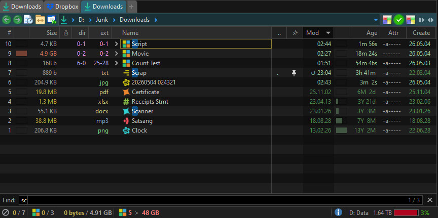

B) Did not work in the same folder in another tab:

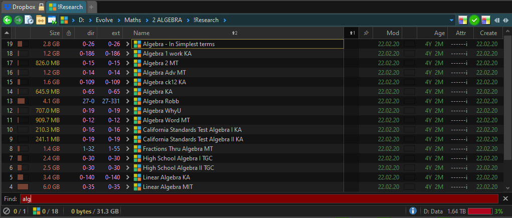

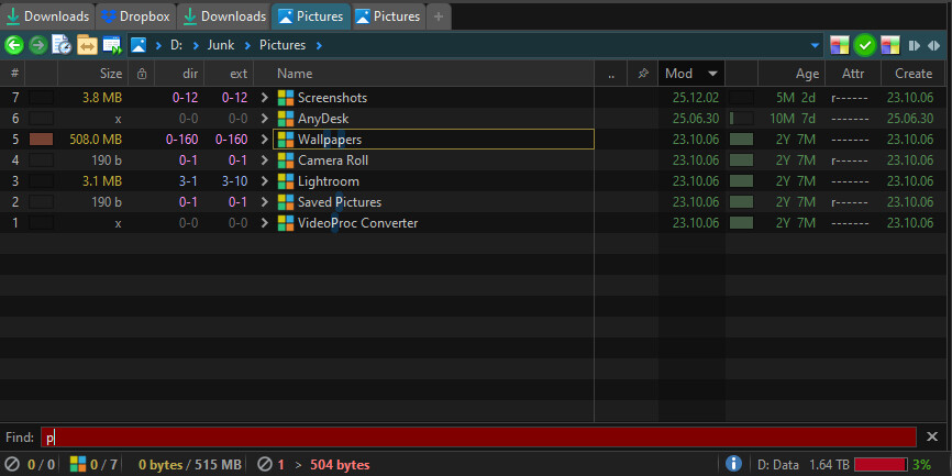

C) Doesn't work in most folders:
D) Funny observation here: It rightly found in the file display but turned into Error mode:

Most of my folders are sorted First by 'User Description'; Second by Name. I use user description to override sorting by name in certain cases. Example:
Downloads and Dropbox folders are exceptions. They are sorted by Modified date.
Irrespective of whether the 'Sort-field specific key scrolling' is turned on or off, find mode is working when the folder is sorted either by Name or by Modified date; and not working when sorted by 'User Description'.
