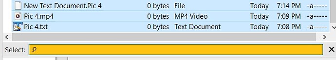

How do I ignore extensions by default when using the FYAT, while retaining 'partial matches' ?
I would have to add an asterix and a period dot to target file types.
Example:
:4
That will select all my .mp4 files. Um, no I want to select "Pic 4".
Quotes doesn't fix it, not that I would want to have to type out quotes every time.

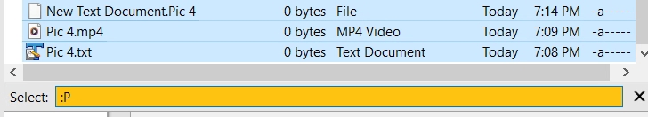

I'm not sure what the problem is.
Just :P works fine here. What part am I missing ?
The problem is it's not ignoring extensions.
If I'm trying to select all file with the number 4 I'm screwed. Or anything with the number 3 all my .mp3's will be selected. This is no good.

Yeah I understand why you want to eliminate the extension from the consideration but I guess it's just not there yet.
All you need is a character adjacent to the number that is different from any character adjacent to the number in the extension or some other easy combination that rules out the extension.
Try adding ? after the number.
I haven't tried this yet. It is only on the fly speculation .
It seems to work so far.
I wouldn't call it vague. File types is the most common thing besides file names; this being on their most common filter tool.
Ah yes, question mark works good! :grinning_face: thanks.
