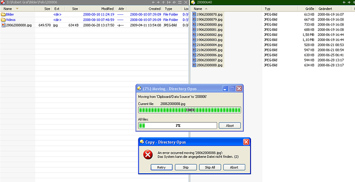

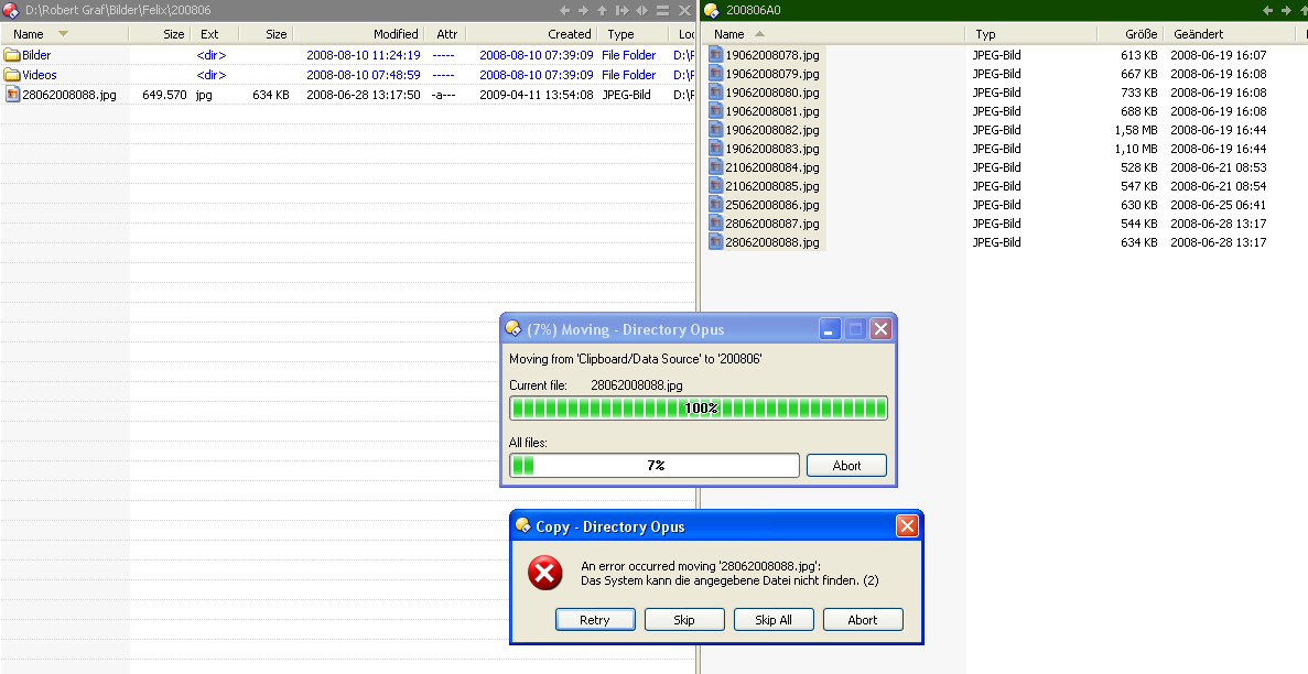

When I try to move a file from my mobile phone (Nokia N95), DO reports an error during the delete part. But it works with Explorer.
The copy part works, but the deletion fails with "An error occurred during moving 'file.jpg': - and the translation from German: "The system can not find the selected file!".
But why can't it be found for deletion? The copy part has worked?
This has to be a bug in DO because it works with Explorer.
See screen shots.
btw: This error happens since earlier versions of DO - I've never reported it. :wink:
Robert

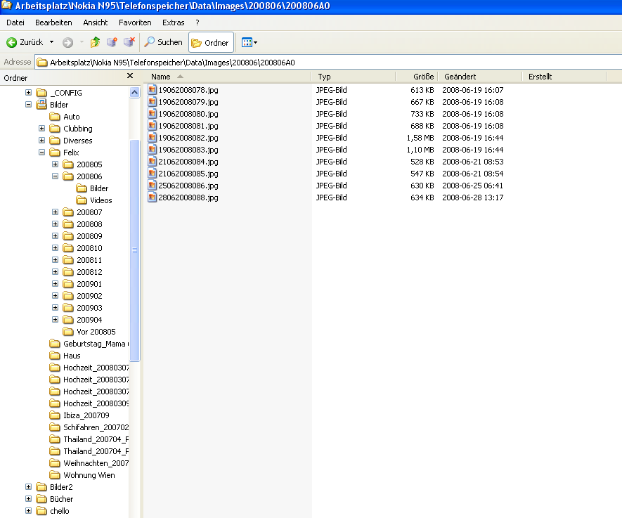

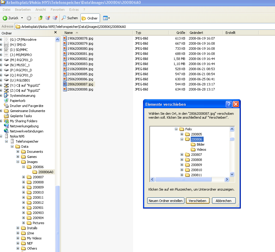

Hmm .. I can't see the file comments - so now here:
N95_move3.png:
Here I try to move a selected file from Nokia N95 into a directory on drive D: - with Explorer
N95_move4.png:
Here you can see that it has worked. The selected file doesn't exist anymore on the phone.
btw: I just see in DO error message: "Moving from 'Clipboard/Data Source'" .. that's mysterious. I've selected the phone - which has a complete other path.
The copy has worked - as you can see on the screen shot - but the delete of the file fails.
