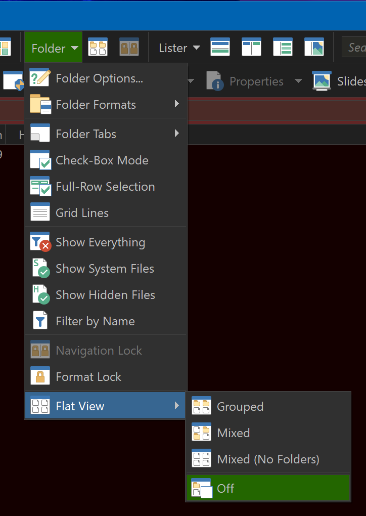

With the default toolbars, you can right-click the Flat View button to see the various modes:
Clipboard%20Image
They are also in the default Folder menu:
Your screenshot clearly shows that you are in Flat View (Mixed) mode, since the Location column shows you have folders from multiple locations. Flat View is on, and in the Mixed mode.
If you want to be in the Grouped mode instead, select that instead.
