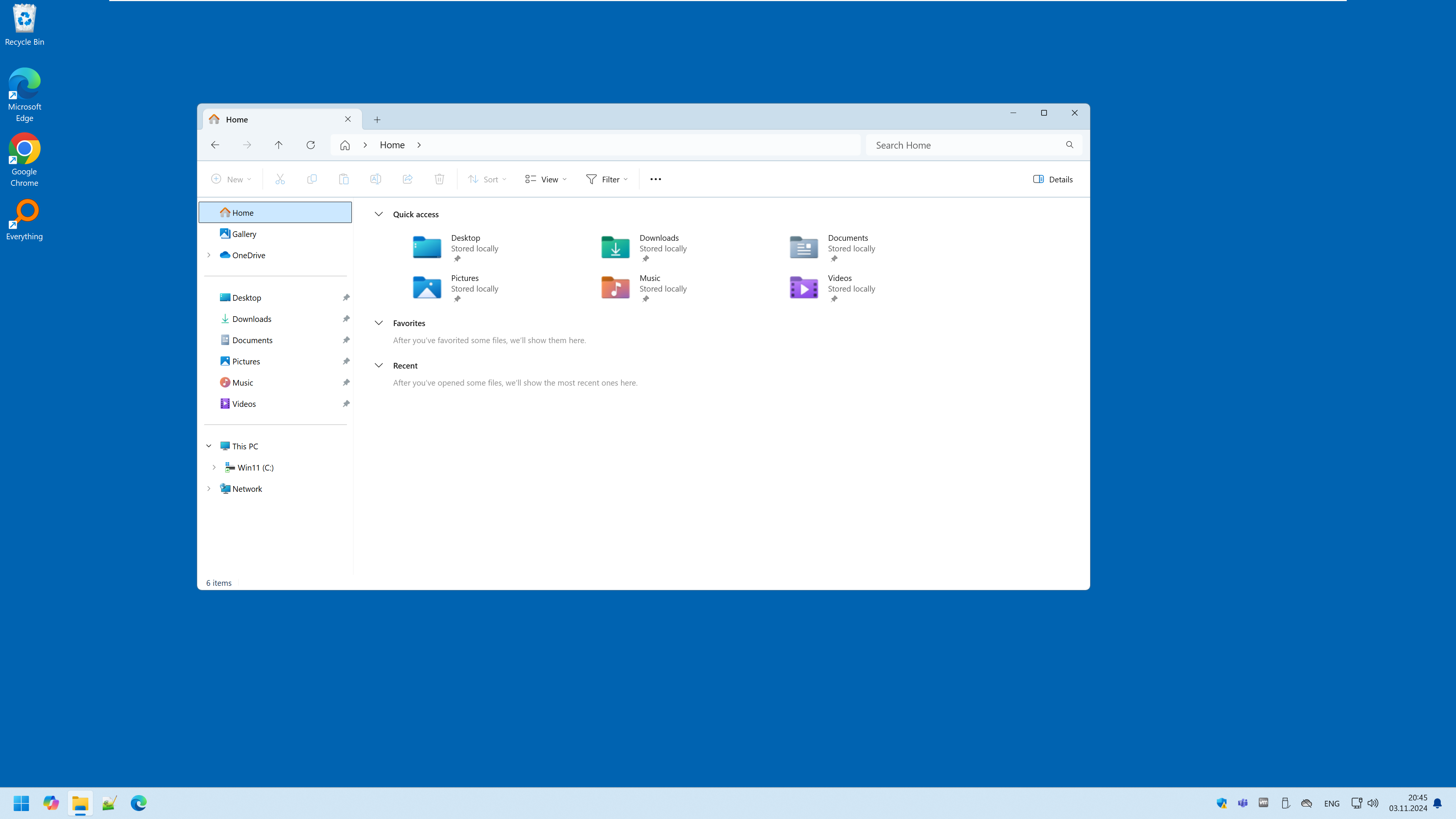

Win 11 looks like this:

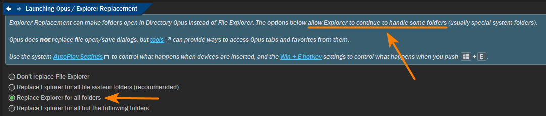

No, Leo already gave me the answer. Then I followed up with a single example of what my issue is. Then Jon replied to me in error. Since multiple programs are still opening things in Explorer, then Dopus isn't doing its job, as per the declarations in the settings:
In my mind "all folders" means all folders. In contrast to "Don't replace File Explorer". The opposite of don't replace is replace. So if I choose anything other than 'don't replace' I expect it to be replaced, as per what it says that it does.

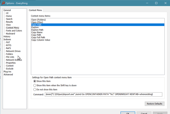

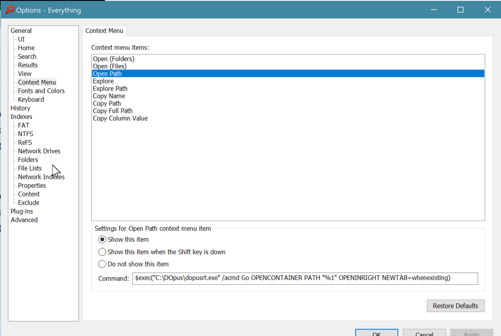

For the double-click folder event of the Everything tool, modify the command lines of "Open (Folders)" and "Open Path".
Open (Folders)
$exec("C:\Program Files\GPSoftware\Directory Opus\dopusrt.exe" /acmd=Go "%1" NEW)
Open Path
$exec("C:\Program Files\GPSoftware\Directory Opus\dopusrt.exe" /acmd=Go "%1" OPENCONTAINER NEW)

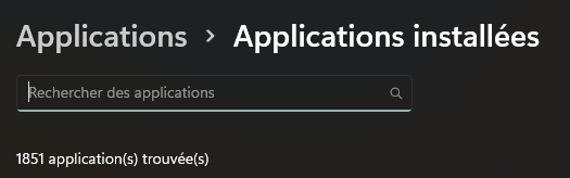

With 1800+ apps installed, I rarely get annoyed by some program opening explorer instead of Opus.
