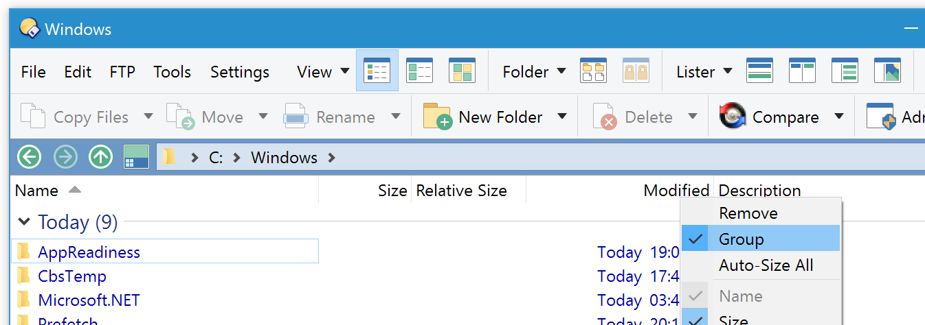

Easiest way is the right-click a date column and select Group:
Date grouping is done similar to the way Explorer does it, by default.
Completely custom grouping is possible by creating a script column, which can specify the group name each item in the column should be filed under.
