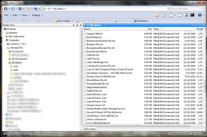

Here is a picture of my D:\music directory showing that I have lots of text files

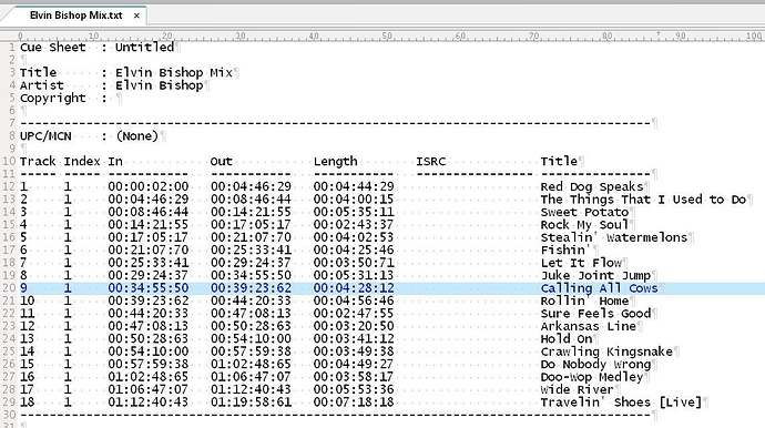

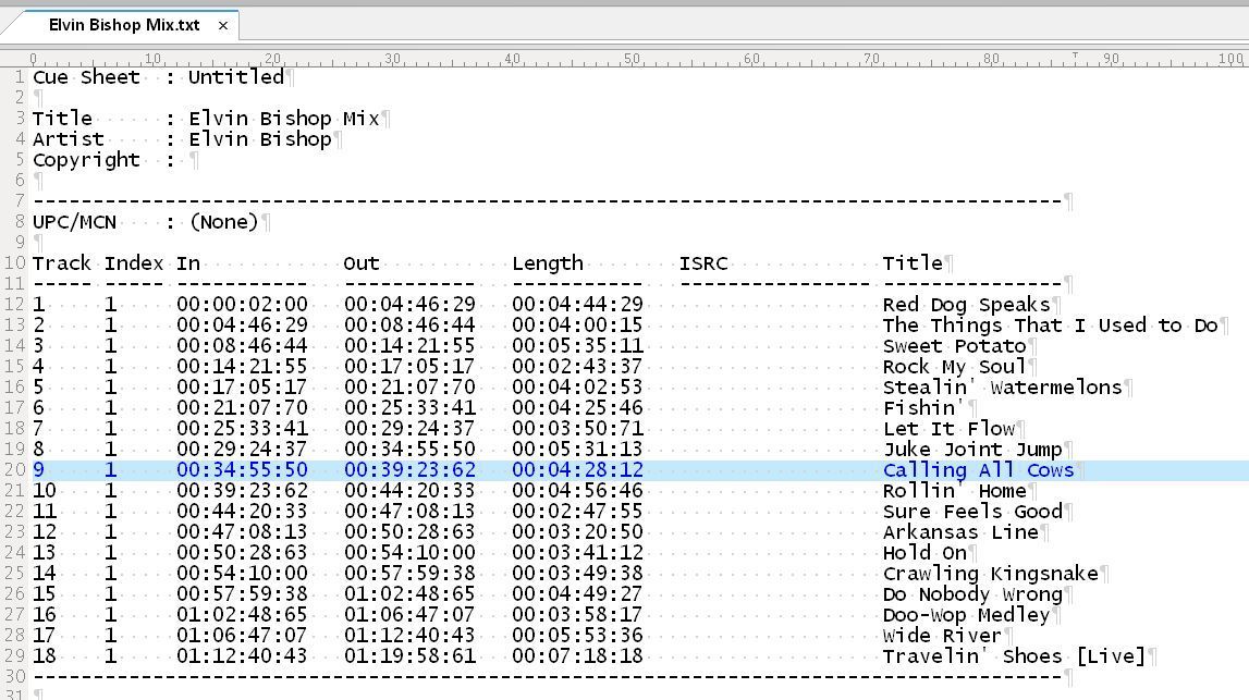

Here is a shot of one file, elvin bishop.txt that shows it contains the word "Dog".

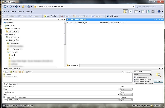

Here is a shot of a search of .txt files in D:\music that contain the word "dog"
In DO9 the results would have found the elvin bishop text file. Not so much with DO 10

[ul][li]If you remove the Containing Text criterion so it searches for all *.txt files, ignoring contents, does it find them all or is it still blank?
(If it's still blank, is D:\Music the same as D:\My Music? The search is done in the former but the screenshot showing the folder is the latter. They may be the same folder with a "localized name", but if they are not then that might explain things. If in doubt, you can turn off localized names via Preferences / Folders / Folder Display / Display localized folder names (Vista and above), although you probably want them on most of the time, so don't forget to toggle it back later if you change it.)

That file is saved as unicode (UTF-16) without a BOM, so Opus has no way of knowing the file format.
(Opus 9 would not have matched its contents either.)
