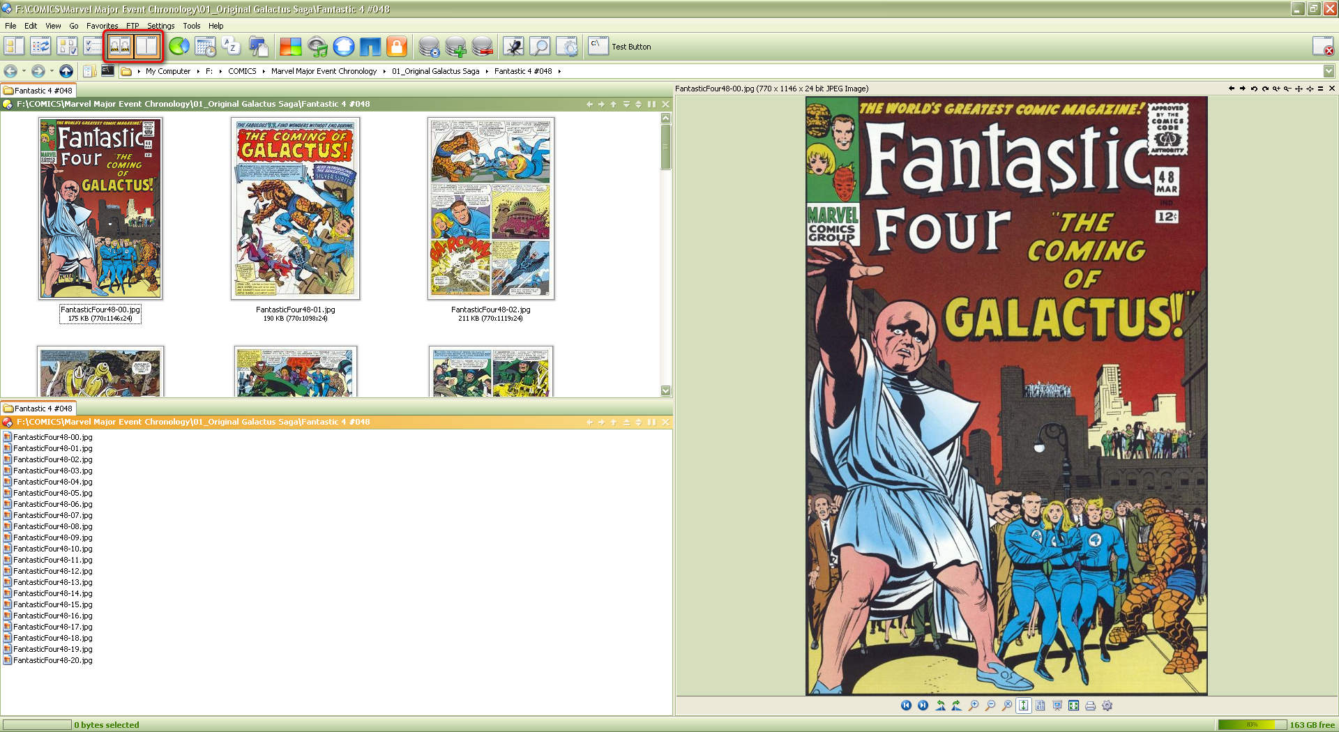

I am trying to set up a horizontal dual pane view where both panes are nav locked on the left and the viewer pane takes up half of the window on the right. The top lister is in thumbnail view and the bottom lister is in List view. I also want to filter out all but jpg/bmp/png.
I am halfway there I think but I'm stuck in a few areas. First, I tried styles but I couldn't get it to use half the window for the viewer pane. It keeps giving me 2/3 lister and 1/3 viewer. I also setup a layout but that doesn't seem to let me filter. It does allow me to get rid of the tree, which is another requirement.

Lister Layouts? Like so?
(click for full-size)
Exactly! So, how can I have a Lister Layout that includes a filter to only show my graphic files? I don't want to see things like .picasa.ini, etc.
