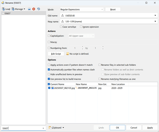

\11 works fine by itself here. It will insert the first capture group, then a literal 1.
We aren't doing that. We're using one of the standard regex libraries and syntaxes.

Looks okay here.
Thanks for the screenshot. Found my mistake: I used "Regular Expressions + Find And Replace" instead of "Regular Expressions". It works now as intended.
