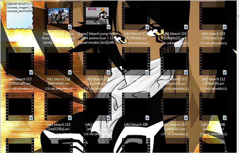

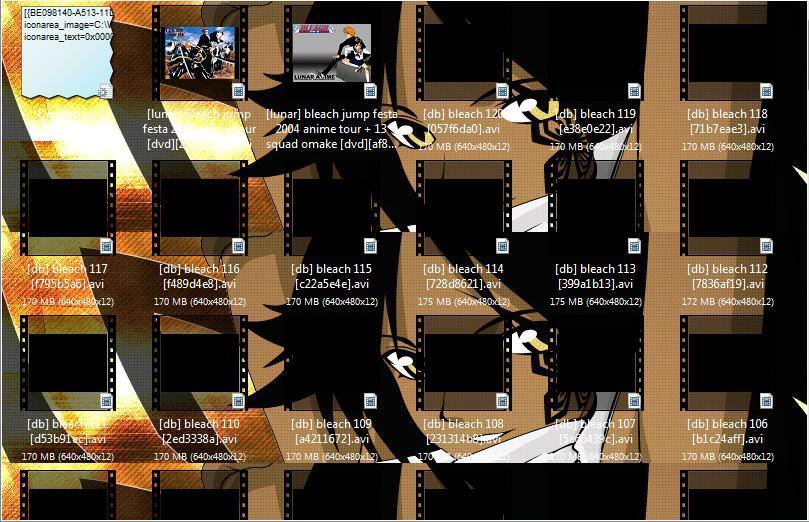

speaking of, i'm not sure if this is relevant anymore (since the way thumbnail handling has been improved?), but here are some pictures showing the distortion i was takling about.
i use thumbnail mode with two lines 24-bit color depth as the wallpaper.
the same thing happens in listview. also, the animated icons are off, thumbnails are high quality, and opus is set to get all the thumbnails even if i haven't scrolled yet, but this distortion happens even if i give opus time to load all the thumbnails.
normal window is the one on bottom, error one is on the top.
thanks for the help!
Looks like the background is being tiled early and/or moving with the thumbs instead of being fixed in place. Don't know why that would happen. Probably not worth worrying about for now. If it still happens with the new thumbnail code in Opus 9 then please raise it again.
