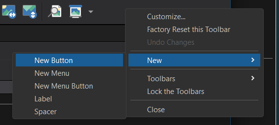

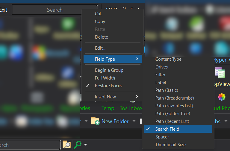

I'm seeking to use an "Input" field type (like search) that enables entering a value into a input field. I do NOT want to pop-up a dialog but instead just type in some value and press enter.
Suggested Implementation
  1. Add "Input" to the Field Type or New submenu.
  2. The "Input" field would look similar to the Search field.
  3. Using "Edit" the new fields labels, description, hootkey, and function or commands would be entered.
  4. The "Input" field data could be referenced as a local variable name.
Are there any suggested ways I could do this or is this a feature that you can add to Dopus?

Have you looked at FAYT scripts? They let you type input and have a script interpret it however it wants, without any pop-up dialog (and without needing to use up any toolbar space either).
