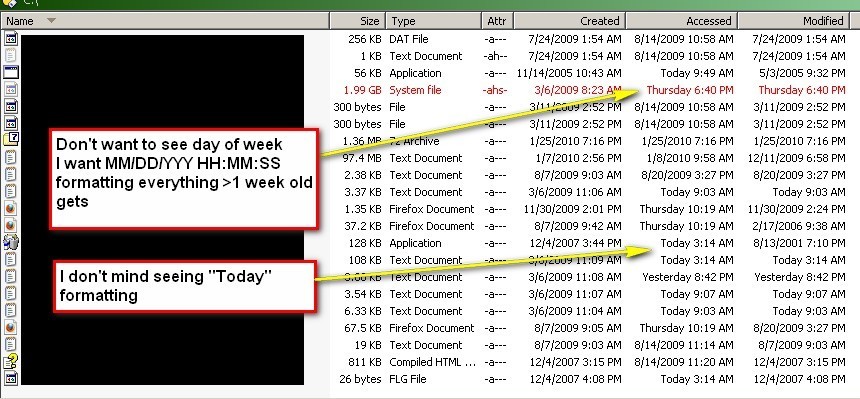

I want to change how DO formats the Modified/Created/Accessed timestamps on files. I don't like how it handles files less than a week old (putting the day of the week only). I don't mind the "today" display so much, but if it had to go to fix the day of week display I'd be fine with that.
Is it possible to change it so that file timestamps are always displayed "MM/DD/YYYY HH:MM" in the details view? Even better would be a hybrid that showed "[dayofweek] MM/DD/YYYY HH:MM"
See the attached screen shot for a clear example

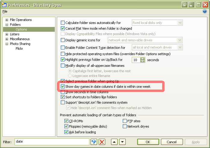

It's either system defined "MM/DD/YYYY HH:MM" style for everything... or the combo of what you're seeing now. Change it with this option:

Besides the general F1 (Help) system... do try out the search/filter field built directly into the Preferences interface. The screen I posted shows that I typed "date" into the field and hit enter - which filters the prefs pages being displayed to those that are relevant - and automatically adds the red selection box to highlight the specific related options/setting.
Of course, it only helps if you search on the "right" keyword :wink:... but it's great for finding stuff and making spot changes to see how they behave as opposed to just reading about them in the F! (Help) system.
