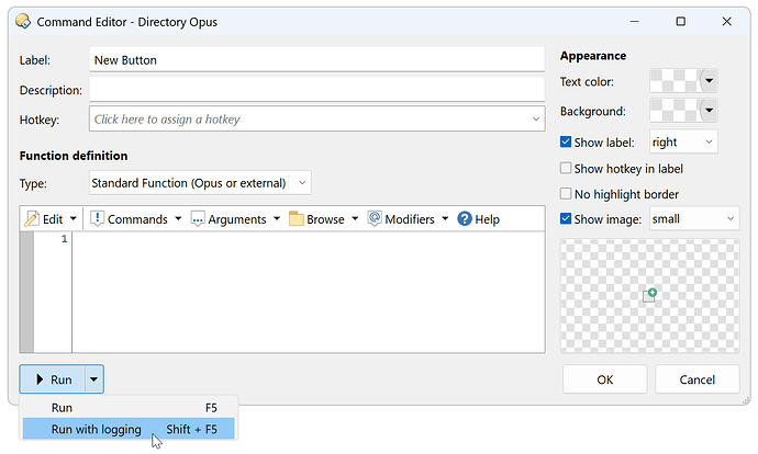

Yes.
Thank you. With the output from "Run with logging" I was able to establish that the final pair of quotation marks was causing a problem.
