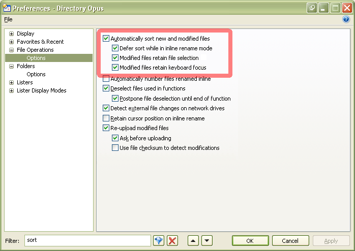

That checkbox only has an effect when the sort order is changed, not when new/modified items are re-sorted according tot he existing sort order.
You could turn off automatic sorting of new/modified items so the file doesn't move in the list at all when renamed but that's probably not what you want either.

So then something like:
Yes, or the simpler single checkbox 'Keyboard focus follow selection after rename', as that would be plenty, and wouldn't result in a lot of extra coding.
