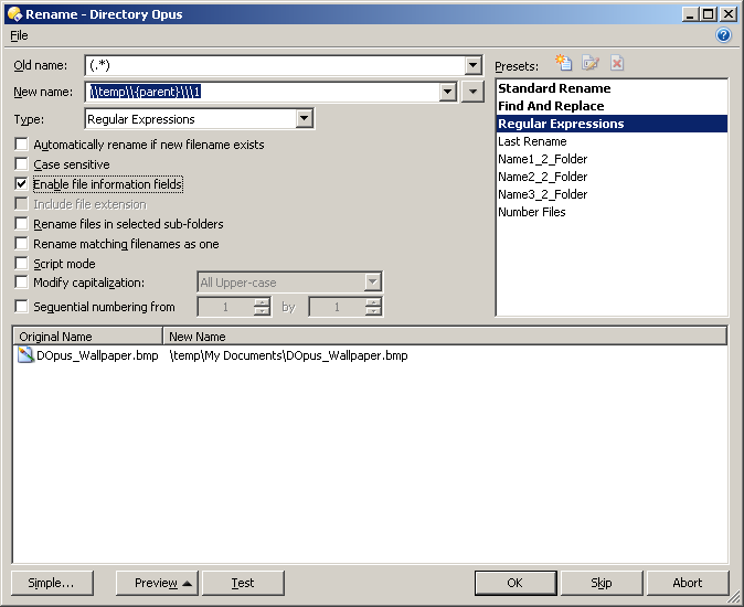

You can either use Flat View and during move choose "Recreate Folder structure". But this works only if the files are all in first subfolders from where you enable Flat View.
Or you can use the the following. This has the limitation only to work on the same drive as you cannot enter ":" in the rename pattern.
You can type : into the rename dialog, but only in Standard Rename mode, and only if it's after a drive letter.
So, extending on Xbprm's idea of using Flat View to select all the files and then the Rename tool, this should do what you want:
(It also only matches *.ai so you can simply select all the files, FWIW.)

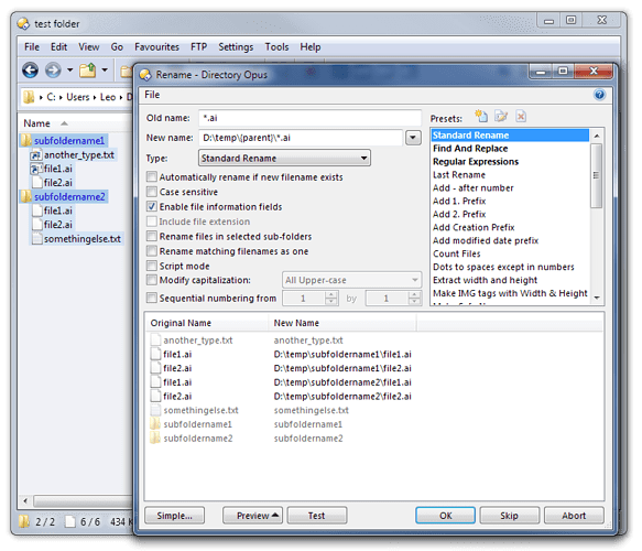

Actually, you don't need to use Flat View; getting all the *.ai files using Find will work as well.
Use the Find Panel (Tools -> Find Panel), set the results to go to a file collection (so they should appear in the lister like a normal directory), then select-all and click the Rename button on the toolbar. (It's between the create folder and delete buttons, near the middle of the default toolbar.)
If you get a small Rename window instead of one like our two screenshots above, click the Advanced button to make it large.
Then setup the Rename window like in my screenshot. (Ignore the list of presets on the right; the important parts are the Old Name, New Name, Type and Enable File Information.)
Check that the Preview display in the Rename window shows the files will be moved/renamed the way you expect before clicking OK!
