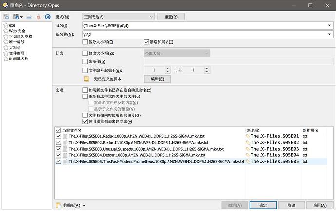

How to rename this case?
I would like to rename following files:
The.X-Files.S05E01.Redux.1080p.AMZN.WEB-DL.DDP5.1.H265-SiGMA.mkv
The.X-Files.S05E02.Redux.II.1080p.AMZN.WEB-DL.DDP5.1.H265-SiGMA.mkv
The.X-Files.S05E03.Unusual.Suspects.1080p.AMZN.WEB-DL.DDP5.1.H265-SiGMA.mkv
The.X-Files.S05E04.Detour.1080p.AMZN.WEB-DL.DDP5.1.H265-SiGMA.mkv
The.X-Files.S05E05.The.Post-Modern.Prometheus.1080p.AMZN.WEB-DL.DDP5.1.H265-SiGMA.mkv
to
The X-Files S05E01.mkv
The X-Files S05E02.mkv
The X-Files S05E03.mkv
The X-Files S05E04.mkv
The X-Files S05E05.mkv
How can I do it quickly by DU rename function? Thanks in advance.
(select Regular Expressions from the Mode dropdown)
非常感謝您,如果要把其中的點一起換成空白呢?
依照您的示範會是:
The.X-Files.S05E01.mkv
如果希望是:
用Regular Expressions有辦法一次改全嘛?還是依您的示範再多加一步Find&Replace將點取代為空白?
旧名:(The)(.)(X-Files)(.)(S05E)(\d\d)
新名:\1 \3 \5\6
Thanks sooo much. :slight_smile:
