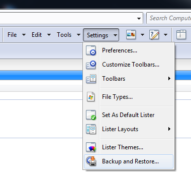

Very strange. The option to export Opus portable to USB should be in Settings > Backup and Restore... (in regular Opus). There you should find option to export portable Opus to USB.
Very strange. The option to export Opus portable to USB should be in Settings > Backup and Restore... (in regular Opus). There you should find option to export portable Opus to USB.[/quote]
