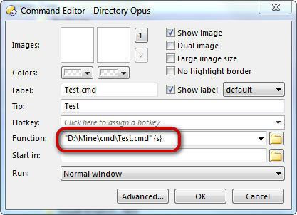

launchee if I understand what you want to do, then I think it would take an external script to do exactly what you want. So here is the way I would do this.
First using Notepad create a new empty text file and paste the following into it:
@echo off if not "%OS%"=="Windows_NT" exit if {%1}=={} exit pushd %1 for /r %%a in (*.exe) do ( type nul>"%%~dpa%%~na%%~xa.txt" del "%%~a" ) popd exit
Save that file giving it a name you want but make sure it ends in .cmd
Next in Opus go to customize mode and create a new button. Set that button up like the one in the screen grab below. You will need to change "D:\Mine\cmd\Test.cmd" in my example to the full path of the text file you created up above. Exit customize mode, go to a test folder with some unwanted .exe files and give it a try.
